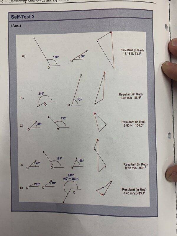

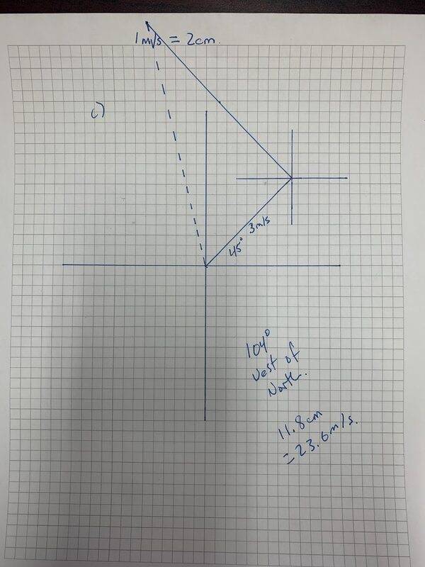

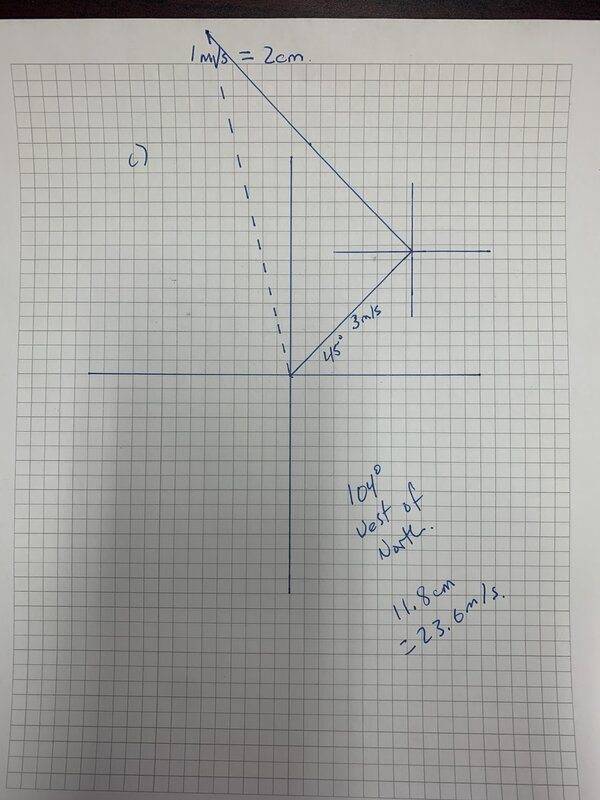

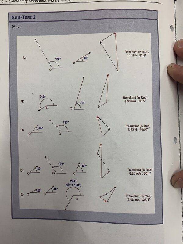

So I've charted the equation above, and received the correct resultant 104.0° I used a scale of 1m/s = 2cm and I get 11.8cm which gives me 23.6m/s but when I look at the answer it is 104.0° / 5.83N
I have no idea why its in Newtons.

Thank you. I have attached both the questions and answers I am referencing. The specific question is "C"
And my answer to the question.

Typographical error.

It is an error of the booklet, the resultant vector should be in m/s.
Note that the angle between your vectors is 90°, therefore, you could apply the Pythagorean equation and see that the result can't be 23.6 m/s.

Ahhhh I see now! My issue was when I ended up with 11.8cm instead of dividing by 2 I multiplied by 2. As my scale was 1m/s = 2cm. I end up with 5.9m/s.
Thanks a million for the help!

When adding vectors, it is good to check that the result is not greater than the addition of the magnitude of each independent vector.
