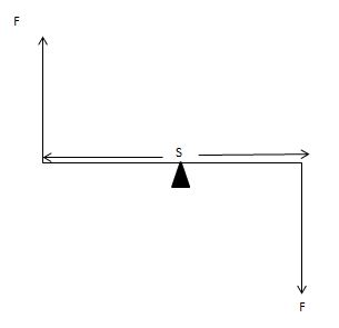

Why is moment ##F.S## instead of ##F.\frac{S}{2}## for this diagram?

Benjamin_harsh
211
##F.\frac{S}{2}##
Why is moment ##F.S## instead of ##F.\frac{S}{2}##?
244181
Why do you think it should be FS/2?
Because pivot is at ##\frac{S}{2}##.
And the forces?
But there are two ##F##.
So, How does it answer my question?
##2*F \cdot \frac s 2 = F \cdot s##. The direction of the two moments are the same, so they add up.
Thank you
There is another way. Since Pivot is not at center. ##\sum M = F.(S-X) + F.X##
so ##\sum M = F.S## since it is clockwise direction, there is no need to multiply -ve sign to it.
