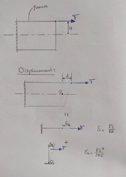

I have a flexure where a asymmetrically force is applied. Why do I have a bending moment + a axial force displacement instead of a bending force?

I have an flexure where the force is applied asymmetrical, I just can't visualize why their should be a bending moment instead of an bending force? How can I distinguish those? Thanks!

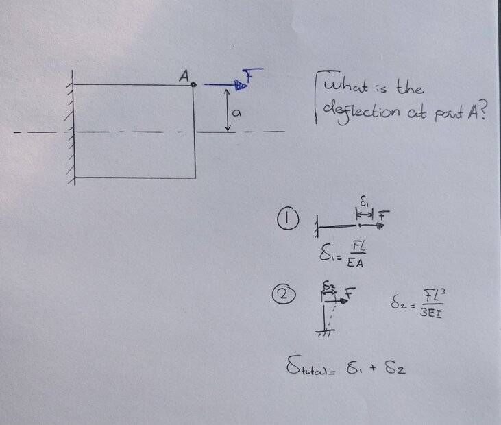

They ask what the deflection is at Point A. I thought their should be axial deflection and a bending force deflection (1 and 2). But the book states that the should be a bending moment instead of a bending force. I have added the equations in the sketch, and here below:
Delta1 = F*L/E*A
Delta2 = F*l^3/3*E*I
*I see the one equation in the original post is wrong, I will try to fix that.
I don’t understand the distinction between bending moment and bending force. A force can result in bending because it has a moment about the centre of the rigid attachment.
Could you post the original text and diagram?

As explained by @haruspex above, there is no moment without a distance and a force.
In this case, the distance of interest seems to be the one separating the neutral fibers from the point of application of the axial force.
