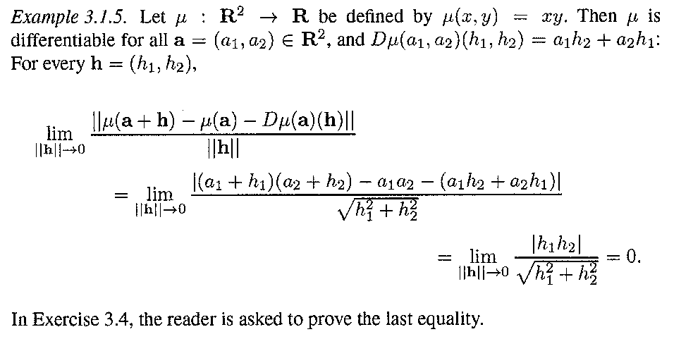

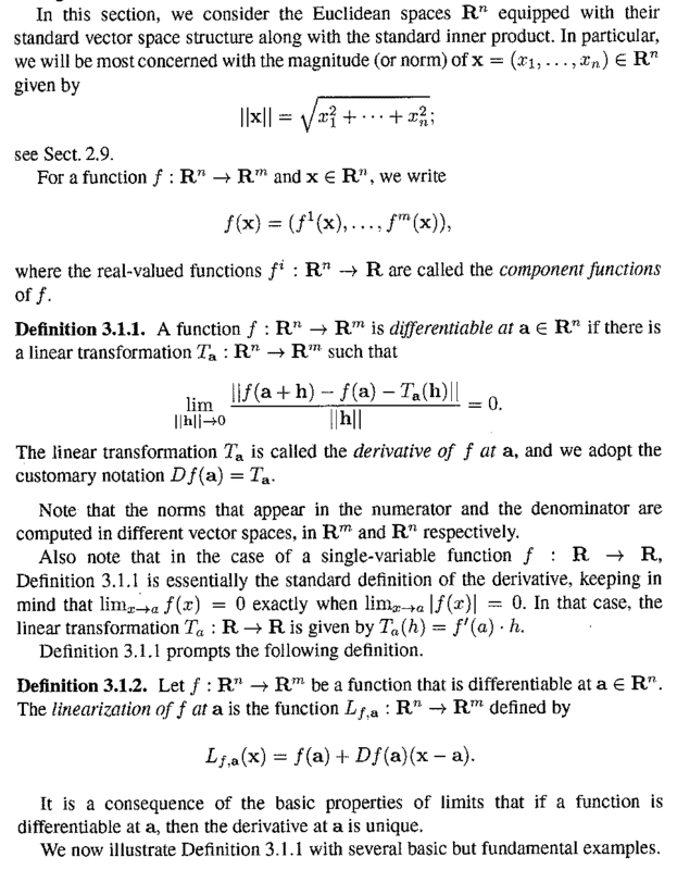

I am reading Andrew McInerney's book: First Steps in Differential Geometry: Riemannian, Contact, Symplectic ... and I am focused on Chapter 3: Advanced Calculus ... and in particular on Section 3.1: The Derivative and Linear Approximation ...
In Section 3.1 McInerney defines what is meant by a function ##f: \mathbb{R}^n \to \mathbb{R}^m## being differentiable and also defines the derivative of f at a point ##a \in \mathbb{R}^n## ...
... see the scanned text below for McInerney's definitions and notation ...
... McInerney then gives several examples ... I need help with several aspects of Example 3.1.5 which reads as follows:
240802
I have two questions with respect to Example 3.1.5 ...Question 1
In the above text from McInerney we read the following:
"... ... Then ##\mu## is differentiable for all ##a = (a_1, a_2) \in \mathbb{R}^2## and ##D \mu (a_1, a_2) (h_1, h_2) = a_1 h_2 + a_2 h_1 ## ... ..Can someone explain exactly how/why ...
(a) ##\mu## is differentiable for all ##a = (a_1, a_2) \in \mathbb{R}^2## ... ...
and ...
(b) ##D \mu (a_1, a_2) (h_1, h_2) = a_1 h_2 + a_2 h_1 ## ... .. that is how/why is this true ...
(especially given that McInerney has only just defined differentiable and the derivative!)Question 2
"... ... ##\displaystyle \lim_{ \mid \mid h \mid \mid \to 0} \frac{ \mid h_1 h_2 \mid }{ \sqrt{ h_1^2 + h_2^2 } } = 0 ##... ...Can someone please show and explain exactly how/why it is that ##\displaystyle \lim_{ \mid \mid h \mid \mid \to 0} \frac{ \mid h_1 h_2 \mid }{ \sqrt{ h_1^2 + h_2^2 } } = 0## ... ...
Help will be much appreciated ... ...

It may help members reading the above post to have access to the text at the start of Section 3.1 of McInerney ... if only to give access to McInerney's terminology and notation ... so I am providing access to the text at the start of Section 3.1 ... as follows:
240803
Hope that helps ...
Peter

For question 1, just interpret the colon ":" as saying "because". The answer to Question 1 is what comes after the colon. The function ##T_\mathbf a## maps ##\mathbf h=(h_1,h_2)## to ##a_1h_2+a_2h_1##. What comes after that shows that the required limit condition in Definition 3.1.1 holds.
To answer Question 2, write ##\mathbf h## in polar coordinates as ##(r\cos\theta,r\sin\theta)##. Then the denominator of the ratio is ##\|\mathbf h\|=r##. What is the numerator? What can we conclude about what the ratio does as ##r\to 0##?

You say you cannot see why ##D \mu (a_1, a_2) (h_1, h_2) = a_1 h_2 + a_2 h_1.## Have you looked at ##(a_1+h_1)(a_2+h_2) - a_1 a_2?## Have you looked at what you get when you keep terms that are of first-order only in ##h_1, h_2?##
Maybe it helps to consider the following. Let ##f \, : \,\mathbb{R}^n \longrightarrow \mathbb{R}^m## be a differentiable function. Then the derivative ##D_af## at ##x=a## in direction ##v## which is a linear function in ##v## satisfies the following equation:
f(a+v) = f(a) + (D_af)(v) + r(v)
where ##r(v)## is an error function with the property ##\lim_{v \rightarrow 0}\frac{r(v)}{||v||}=0 ##, i.e. it converges faster to zero than linear.
Try to write your function in this form.

After reflecting on my last post ... I thought I would try to answer my own question ...
So ... we have ##\mu(x, y) = xy##
and
##D \mu ( a_1, a_2) = ( D_1 \mu ( a_1, a_2), D_2 \mu ( a_1, a_2) )##
##= \left( \frac{ \partial \mu}{ \partial x } ( a_1, a_2) , \frac{ \partial \mu}{ \partial y } ( a_1, a_2) \right)##
##= ( y \mid_{ ( a_1, a_2) }, x \mid_{ ( a_1, a_2) } )##
##= (a_2, a_1 )##
and so we also have
##D \mu ( a_1, a_2) \left( \begin{array}{cc} h_1 \\ h_2 \end{array} \right)##
##= a_2 h_1 + a_1 h_2 ##
Is that correct?

Yes that is correct.
It helps to nail down some terminology. I think 'differential' is used for the linear map ##T_\mathbf a:\mathbb R^n\to\mathbb R^m##, which we can call the 'differential' of ##\mu## at ##\mathbf a##.
'Derivative' is used for the map from ##\mathbb R^n## to ##S##, where ##S## is the set of linear maps from ##\mathbb R^n## to ##\mathbb R^m##, which maps each point ##\mathbf a\in\mathbb R^n## to the differential of ##\mu## at that point, ie to ##T_\mathbf a##.
The method for calculating the differential at ##\mathbf a## is to calculate the Jacobian matrix of the function ##\mu## at ##\mathbf a##. The differential is the linear map represented by that matrix. that is what you have done in your latest post above. The wiki link shows you how to calculate the Jacobian matrix in the general case. Note the para that starts with "The Jacobian matrix is important", which explains how the linear map associated with the matrix is the ##T_\mathbf a## that your text writes about.
