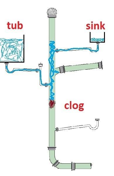

Quick hijack. My bathtub drain has been super slow, but the bathroom sink got clogged to the point of standing water that would take overnight to drain.
So I poured draino down the sink and cleared that clog. Next, I went to the shower and ran the water, knowing it would back up, and the drain ran fine. Clearing the sink clog fixed the bathtub drain. Anyone know why?

Diagram of a bathroom drain system with a vertical main pipe, a tub and a sink connected by side branches, and a red clog marked in the pipe with blue hair-like debris accumulating above it.
[/END HIJACK]
  • Diagram of a household drain system with a vertical pipe, a tub and a sink connected to it by side branches, and a red clog marked near the bottom of the vertical pipe, with blue tangled hair-like strands catching in the pipe above it.
dlgoff said:
Diagram of a household drain system with a vertical pipe; blue tangled hair-like clumps fill the pipe, with a red clog marked clog lower down. Tub and sink branch in with labels tub and sink.
[/END HIJACK]
GASP! That's not my hair BTW! That's Evo Child's hair! The hair dressers would charge me double to cut her hair when she was little, they all said she had the hair of three people. No one wanted to do her hair, it took forever.

I noticed there's like little hairs inside my sink every once in a while when the water comes up into the sink. The hairs aren't the color of my hair. I live alone. Oh god.
