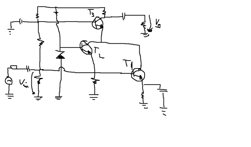

Why is T2 removed in low signal circuit analysis?

  • Hand-drawn transistor circuit schematic with a sinusoidal source and resistor at the input feeding transistor T1, then T2 and T3 stages with resistors to ground, and output labelled Vout.

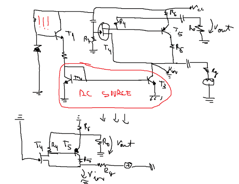

  • Hand-drawn small-signal transistor circuit with transistors T1, T2 and T3, a diode, resistors, capacitors, a signal source Vin and output Vo, with ground symbols.
Drao92 said:
Sure
The DC source is above the T3 transistor and resistor, i forgot to draw it.
The problem i have is that i can't understand what parts of the circuit i have to remove when i move from DC analysis to AC analysis. Can you recommend me a book or some documentation which explains this because i couldn't find any.
https://www.physicsforums.com/attachment.php?attachmentid=57846&stc=1&d=1365923347
What is the component connected below the base of T2? Maybe a Zener diode?
What class is this for, and what is the standard textbook? Most textbooks on standard transistor analysis should cover how to analyze this circuit...
I study amplifiers. Yes, its a zener diode.
The standard textbook is not in english and it doesn't cover these things.I made these on seminars
Ill post another example.
So, the T2 and T3 transistors make a DC source and its a ground in AC, but i don't understand why the T1 transistor is a ground too. This is the problem i have.
After i make the AC circuit i have to calculate Vo/Vi, Rin, Rout, very easy but if i don't know how to make the AC circuit is useless .
https://www.physicsforums.com/attachment.php?attachmentid=57856&stc=1&d=1365959633
  • Hand-drawn transistor amplifier circuit with a red loop marked DC SOURCE around transistors T2 and T3, arrows pointing down to a simplified AC equivalent with R6, R4, T5, Rb, Rg and the labels Vout and Vin.
T3 is not a ground for AC. In fact, it's infinite impedance (theoretically) for AC. It's a source of dc current. A current source has infinite impedance. In fact, the collector of T3 is your input voltage point.
T1 is also a current source. The function of T2 is to mirror the current through its collector to the collector of T3. T1 defines the collector current for T2 and trerefore for T3 also. T3 defines the operating point of the grounded-gate JFET amplifier.
