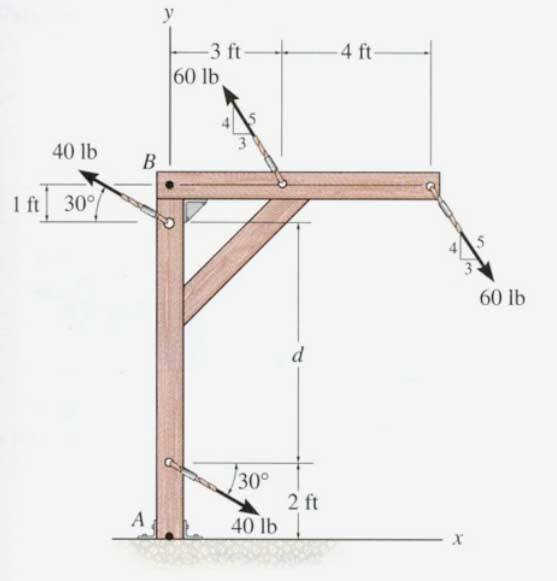

Why is the couple moment negative in this example?

Hey, I'm having some difficulty calculating couple moment. i understand that [tex]\sum[/tex]M = [tex]\sum[/tex]Fd. here's an example:
Frame diagram with a vertical member A-B and horizontal member at top; forces of 60 lb (3 ft and 4 ft from the vertical member), 40 lb at 30 degrees left, 40 lb at 30 degrees near bottom, dimensions 1 ft, 2 ft and d, and x-y axes.
it asks to resolve the couple forces.
the answer is:
(4/5)(60lb) = 48lb
and
(40lb)(cos30)
[tex]\sum[/tex]M = -(48lb)(4ft) + (40lb)(cos30)(8ft)
Now, i don't understand why "-(48lb)(4ft)" is negative. I'm not sure when to use a negative value. Can someone explain this to me?
Cheers

It's a matter of convention. Typically, the clockwise direction is negative and counter-clockwise is positive. So if the applied force causes rotation in the clockwise direction, the moment is negative and vice-versa.
