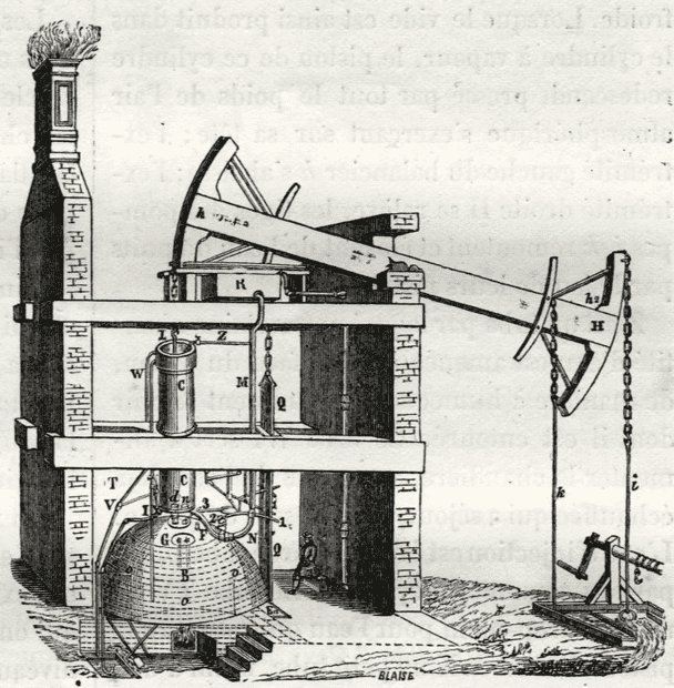

Story time! The word "work" was actually coined by Carnot in "Reflections on the motive power of fire" (1824) and derives from an analysis of the performance of steam engines used in mining. These were used to pump water out of mines, and the amount of "work" a steam engine can do could be quantified in terms of the product of the weight of the water lifted and the distance raised (out of a deep hole in the ground).
Fig: Newcomen's engine
