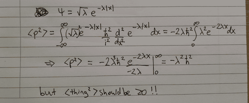

Find <p^2>
NA
psi is given above. I have checked multiple times but can't find my mistake. Thank you!
My first thought is that you have to split the integral because of the modulus.
This is a bound state (can you tell me what fictitious potential?) Does it make sense now?
If you calculate it as ##\langle \psi \rvert p^2 \lvert \psi \rangle = \langle p\psi \vert p\psi \rangle##, you'll get a positive answer. My guess is that it's the discontinuity in ##\psi'## at ##x=0## that's causing your problem.
Distributionally
$$\frac{\mathrm d^2 }{\mathrm d x^2} (e^{-\lambda |x|})= \lambda^2 e^{-\lambda|x|}-2\lambda \delta(x)$$
