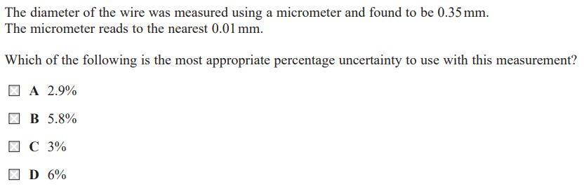

Why is the final answer for the micrometer measurement 3% instead of 2.9%?

I thought that since he micrometer is to 2 significant figures (0.35 and 0.01mm) that the final answer should also be to 2 sig.figs, thus answer A.
But the final answer is C, 3%. Can someone explain why?
0.01 is one significant digit. Leading zeros do not count.
Yes, but the marks on the micrometer will be rather more accurate than to the nearest 0.01mm. If you take a reading to the nearest 0.01mm according to the gradations, the actual error will be +/-(0.005+ε) where ε is the error range for the gradations.
So there is insufficient information to say how many significant digits should be quoted, but two seems reasonable.
Worse, 0.005/0.35 = 1.4%, not 2.9%.
