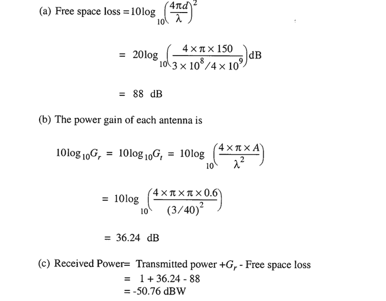

Why is the Gain of the Transmitted Antenna Not Considered in the Solution?

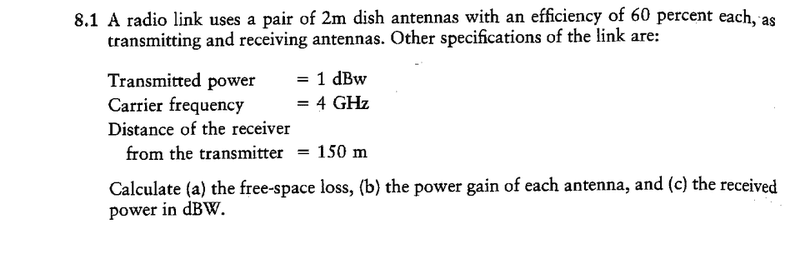

The solution does not take into account Gain of transmitted antenna. Why?
From friis eqn, Pr(db)= Pt+Gt+Gr-Lp, but soln. omits Gt
soln below

This looks like an error to me, too.
