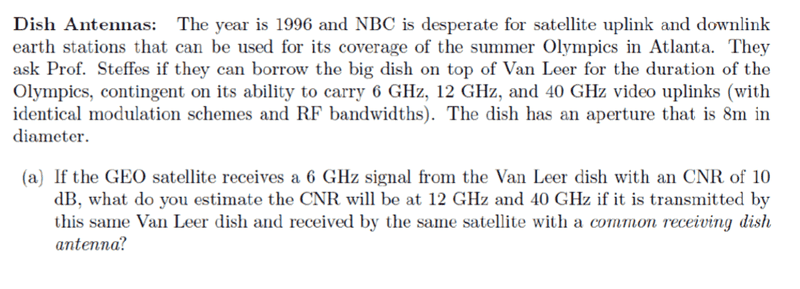

Summary:: I am stuck on a problem on dish antenna C/N and it's relation to frequency. Please see below for thought process.
Problem Statement:
Text problem statement on dish antennas: a 1996 question asking how the C/N of an 8 m dish transmitting 6 GHz, 12 GHz and 40 GHz video uplinks would change, given a 10 dB CNR at 6 GHz.
Link budget formula in dB form: Pr = Pt + Gt + Gr + 20*log10(lambda/(4*pi*distance)) - Losses [dB]
C/N = Pr - Pn [dB], where Pn = 10*log10(k*T*B)
I am stuck on coming up with the final answer. Without knowing all the details (RX/TX powers, antenna efficiency, additional losses, etc.), I can only conclude that some factors are equal, like noise power. The antenna gains Gt, Gr, and free space propagation losses all are frequency dependent and are proportional to f^2, so with 2 gain factors and 1 loss, my net C/N increase would be with respoect to 1 f^2. I'm just not sure how to proceed from here. any help is very much appreciated.
Antenna gain ∝ 10 log (pi D / lambda)^2
So gain rises with freq squared.
At 12 GHz:-
Increase in gain of Gt at 12 GHz = 20 log 12/6 = 6dB
Increase in gain of Gr at 12 GHz = 6dB
Path loss is also dependent on freq squared, so it will increase by 6dB at 12 GHz
Pr change = Gt + Gr - Lp = 6 + 6 - 6 = +6dB
CNR = 10 + 6 = 16dB
At 40GHz:-
Increase in Gt at 40 GHz = 20 log 40/6 = 16,5dB
Increase in gain of Gr = 16.5 dB
Path loss increase = 20 log 40/6 = 16.5 dB
Pr change = Gt+Gr -Lp = 16.5 + 16.5 - 16.5 = +16.5 dB
CNR = 10 + 16.5 = 26.5 dB
At 12 GHz:-
CNR = 10 + 6 = 16dB
At 40GHz:-
Hi tech99. Thank you for your reply and help. I'm a little confused on how you went
from
G_ant = 10 log (pi D / lambda)^2 or 20 log (pi D / lambda) = 20 log (pi (8 m) / [(3e8 m/s)/ 12e9 Hz)] ) to
20 log 12/6 above for the Increase in gain of Gt/Gr at 12 GHz.
Would you be willing to explain?
If we take the log of a number squared, that is the same as twice the log of the number not squared.
10 log N^2 = 20 log N.
I think that is the confusion.
Not really. I understand that. I’m having trouble understanding how you got the 20log(12/6) and 20log(40/6) parts above.
The antenna power gain is proportional to frequency squared. If we increase the frequency from 6 to 12 GHz, the power gain rises by (12/6)^2 = 4. Or in decibal form Gain Ratio = 20 log 12/6.
The 40/6 mentioned is the frequency ratio between 6 GHz and 40 GHz.
I see that now. Thanks for the explanations; this cleared things up. Would you mind if I annoyed you with a follow-up question to this scenerio?

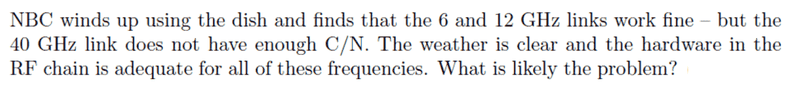

Printed problem text: NBC winds up using the dish and finds that the 6 and 12 GHz links work fine, but the 40 GHz link does not have enough C/N. The weather is clear and the hardware in the RF chain is adequate for all of these frequencies. What is likely the problem?
As to why this antenna will fail to deliver more power gain at the higher frequency, I can only think of atmospheric attentuation, mostly rain, but the problem says that the weather is clear. I'm not an expert at antenna design, do you have any thoughts?
Maybe the dish profile is not accurate enough for 40 GHz. At this frequency, the profile would need to be within, say, an eighth of a wavelength, which at 40 Ghz is only a small distance. Lambda = 300/40 = 7.5mm, so Lamba/8 is approx 1 mm.
