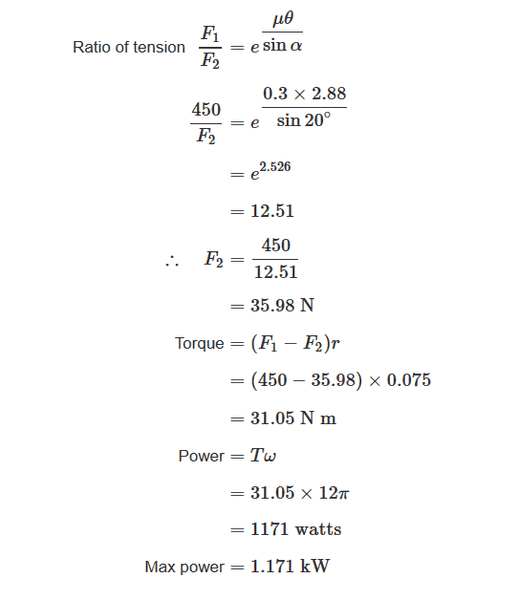

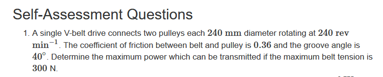

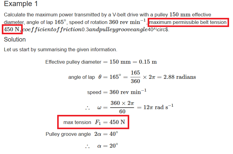

I try to follow the examples and in lessons. I have had a read through all the lesson content and example questions but I cannot find any information on how to find the rotation speed of the second pulley? I have already obtained the speed of the driving pulley of diameter 150 mm at 24.13 rad sec^-1 and I have the diameter of the second pulley at 400mm, but I do not have an equation to solve the difference in speed transmitted? Also once I obtain this value I do not have an equation to use it when I am looking for the actual power? I have collected a fair amount of information already, can it be done with what I have in my notes?
I have some similar example lessons where I can swop out the values to suit my question but I don't have some of the values given, here is one example, most apear to require transposition for two unknown values in solving the equation?

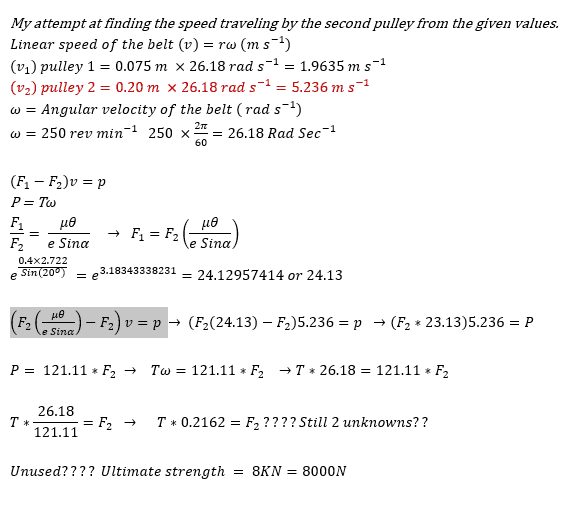

You seem to have assumed the second pulley is rotating at the same rate as the first (even though this is what you needed to calculate) and deduced a different linear speed (5.236 ms-1).
Since the belt is not slipping, what can you say about the two linear speeds?

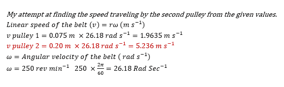

Apologies for the screen shots, I prefer to type up my working out in Microsoft Word because its quicker to type up equations. I will add a reference to each one in future.
I have highlighted my answer for the linear speed of the second pulley in red? The speed for the first pulley was 1.9635 m s^-1 therefore I have attempted to show the difference in rotating speeds of the two pulleys. However I had worked out on paper a different method.
I took the diameter of each pulley 0.150 m and 0.4 m and multiplied them by 2pi/60 to get 0.0157 rad sec^-1 and 0.0419 rad sec^-1 but I thought this was totally wrong so I scrapped it. I do not have an equation to work this rotational difference out. Can you suggest one?
But to do that you assumed it had the same rotational speed as the first pulley, which is clearly false.
Think about the linear speed of the belt. How does that relate to the rotational speed of a pulley of radius r?
I have tried to copy and paste the equations from Microsoft word but it looses all format when transfered. I am sorry but i do not understand your meaning creating LaTeX? I presume its a format I can copy into?
I can see now what you mean with regards to the rotational speed. The first pulley is much smaller than the second so would turn at more than twice the rate. How would I show this? Could it be the 250 revs min / diameter of each pulley?
See if this helps: https://www.dessci.com/en/products/MathType/popup_tex_in_word.htm
As I wrote, think about the linear speed of the belt. If a pulley radius r rotates at rate w, what is the linear speed of the belt around it (assuming no slipping).

As the driving pulley is 150 mm diameter or 75 mm radius and the measurement of linear speed is in meters per second, I would use the radius in meters of the driving pulley, or 0.075 m. The equation I would use to work out Linear speed is given as v = wr.
w was provided in the question as 250 rev min but I needed the answer to be converted to seconds. So 250 * 2pi/60 = 26.18 radians per second.
Therefore the linear speed of the belt would be 26.18 * 0.075 = 1.9635 meters per second( Assuming no slip). This would obviously be the same for both pulleys, however the driven pulley is 166% (83/50) larger than the driving pulley therefore a full rotation takes longer. So using the previous equation v = wr
1.9635(v) = w * 0.2(r) transpose for w gives 1.9635/0.2 = w.
As a pulley radius r rotates at rate w then the driven pulley rotates at 9.8175 radians per second.
Does This look ok?

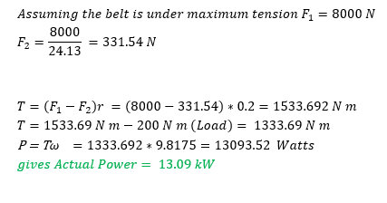

Continuing my attempt at solving this, following my answer to the rotational speed of the driven pulley. I have screen shot my work but referenced each method part 1 to 4.
Also giving the same results
Scrap that last attempt:
No, in all those attempts you have assumed maximum tension. Part a) does not say maximum tension.
You know the rotation rate of the second pulley, and you know load torque.
Dammit! I thought I had it on my last attempt.
So.. the Load torque. Is the load torque a resitance to turning? e.g a lawn mower would have a turning blade hitting the grass and the grass is resisting the blade from turning would be the load torque? or is it the Load which is on the belt tensioning the two pulleys? I think this is where I remain confused.
Surely It can't be as simple as T = 200 Nm
P = Tω
So 200 * 9.8175 = 1963.5 Watts or 1.96 kW?

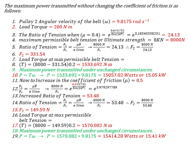

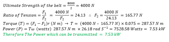

Great! Finally a correct answer! I think my initial answer for b is ok but I know I have made a mistake in c part 1. Can you advise anymore?
There are also 2 more parts to this question I haven't yet posted. Thanks

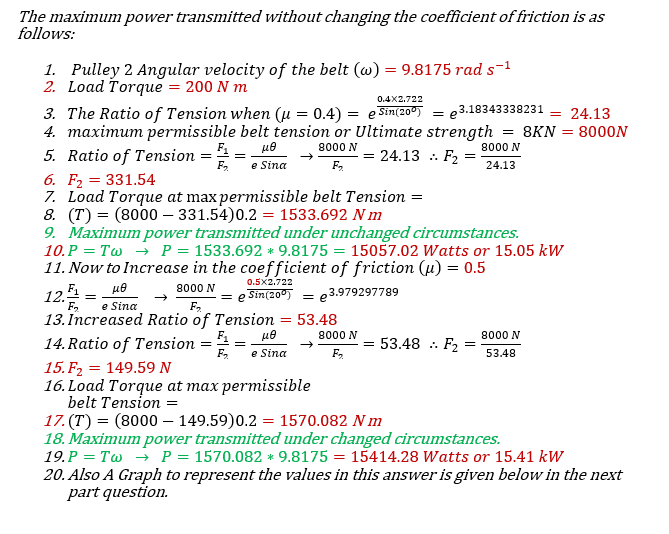

Yes, b looks right.
For c(i), you pointed out that the tension ratio could be increased. But then consider what that means for F1 and F2. F1 is still at max, right? So, physically, what would you do to the belt to make use of the increased friction?

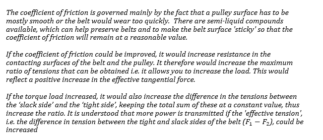

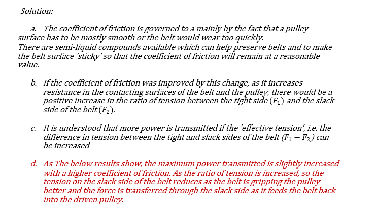

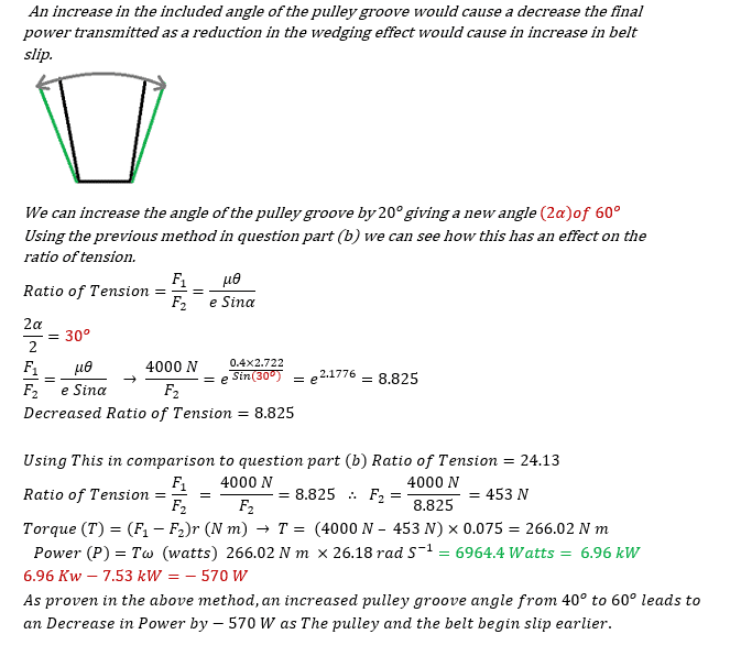

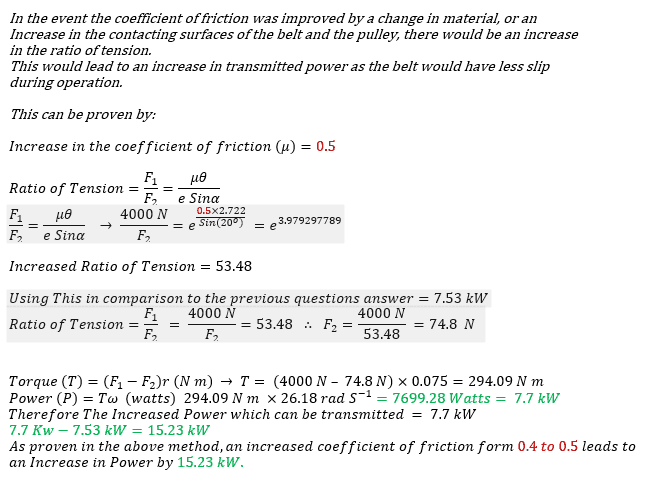

In my notes I have wrote:
If there is a higher coefficient of friction, the belt grips more to the pulley which has a negative effect on the slack side of the belt (causing the slack side to become more slack) as it carrys it over the pulley and transfers the power to the 2nd pulley. Although the ratio of tension increasing to 53.48 from 24.13 would suggest ot me, the belt has become tighter on the slack side?
While F_1 is still at the maximum tension of 4000 N, I would expect the belt to become slacker on the slack side with an increase in the coefficient of friction?
I think that is wrong.
Once there is enough static friction to prevent slipping, increasing the coefficient of friction (and changing nothing else) has no effect. Remember that the static frictional force Fs is not necessarily equal to FNμs. That is only an upper limit on the force. Increasing μs does not of itself change Fs.
Given a higher coefficient, what can you change and still get an adequate frictional force?
I have a few options within the ratio of tension equation which I could change.
e^(μθ/sinα) =F_1/F_2
The angle of lap (θ) is fixed due to the size of the pulleys being fixed.
The groove angle (sinα) again is fixed at 20^o
The exponential term cannot be changed.
So we would need to change the belt Tension in F_1/F_2
Then using the ratio of tension equation I should be able to work out F_2.
I will spend some time tomorrow working on this and post my results.
Thanks

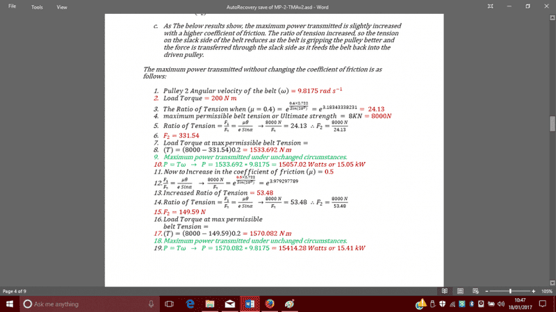

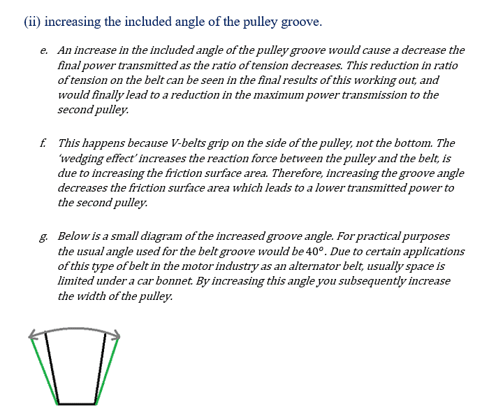

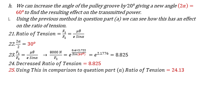

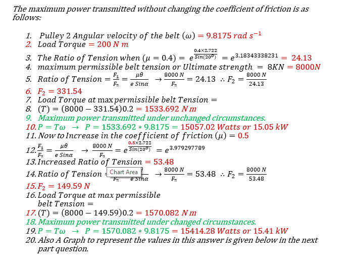

Ok I have made an attempt at the full question:
I have labeled each part of my method for reference. I hope this helps if I have made any mistakes?
Scrap that last attempt, I have spend some time today working on this. here are my workings with reference tags to each part.
Does this look acceptable?
