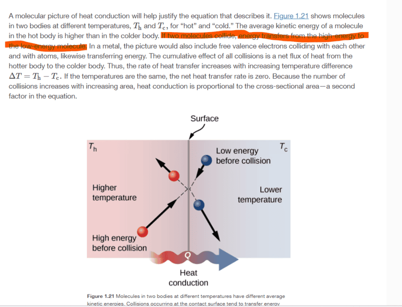

Can someone please explain to me why the highlighted statement true?
Many thanks!
Simple kinetics. Consider two equal masses head-on in a perfectly elastic collision. Can you write the equations for the resulting velocities?

Or, some down-to-earth comments.
Have you played or watched a game of pool or billiards?
Have you ever witnessed a car collision where a car hits a stopped car?
Is there any movement of the stopped object when it is hit?

ok, except that the statement under consideration appears to claim it as general fact, not as merely typical.

You should be able to combine the momentum and energy conservation laws to obtain: ##v_{1i}- v_{2i} = v_{2f} -v_{1f}##. (This is even if the masses differ, and is a very useful equation to remember. There's also a more general form involving coefficient of restitution.)
What does that allow you to deduce when the masses are the same?

We have ##v_{1i}- v_{2i} = v_{2f} -v_{1f}## and the momentum conservation equation ## m_1v_{1i}+ m_2v_{2i} = m_1v_{1f}+ m_2v_{2f} ##. For the special case of equal masses, the latter reduces to:

What do those two equations that only involve velocities tell you?

You should be able to reforumulate eq. (1) using the conjugate rule in order to invoke eq. (2) to get the velocitiy-relation that haruspex wrote.

That was a first step. The generalisation to oblique collisions is easy: just take the velocity components in the line of centres.
More problematic may be differing masses.

But having one mass at rest initially is just to transform to its rest-frame

The distribution of KE looks different in different inertial frames. Two observers may disagree on which started with the greater KE. Yes, they will agree that the roles swapped, but this is likely to make the argument unconvincing to some.
