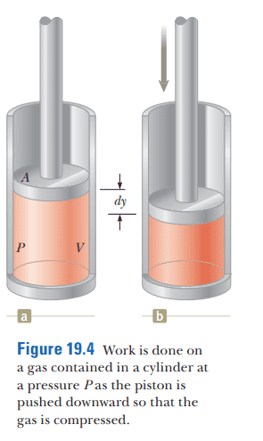

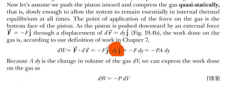

For this derivation,
I am not sure why the bit highlighted in orange is not positive since the displacement of the piston is downwards in the same direction as the force applied.
Many thanks!

It appears to be a notation/convention issue.
When we write ##\vec F = -F {\hat j}## the (unadorned) letter ‘##F##’ means the magnitude of ##\vec F##. This is a common convention – shorthand for writing ##|\vec F|##. Of course, ##F## is, by definition always non-negative.
But ##dy##, it is not a magnitude. It is an (infinitesimal) change in ##y##. It can be positive (an increase in ##y##) or negative (a decrease in ##y##).
In the situation described, ##-PAdy## will be positive because ##dy## is negative.

It appears to me that y is taken to be positive up, so dy will be negative. That is independent of which way the force acts.

By definition
##d\mathbf{r}=dx~\mathbf{\hat {i}}+dy~\mathbf{\hat {j}}+dz~\mathbf{\hat {k}}.##
Here, ##\mathbf{F}=-F\mathbf{\hat {j}}##.
Therefore,
##\mathbf{F}\cdot d\mathbf{r}=(-F\mathbf{\hat {j}})\cdot(dx~\mathbf{\hat {i}}+dy~\mathbf{\hat {j}}+dz~\mathbf{\hat {k}})=-Fdy.##

Thank you for your reply @Steve4Physics !
So are you saying that the textbook is wrong since ##\vec dr = -dy\hat j##?

But why dose ##\vec dr## not equal ##-dy\hat j##?

Because ##\vec r## and ##y## are both positive upwards. ##dy## will have a negative value.
##\vec r=y\hat j##
##\vec r+\vec dr=(y+dy)\hat j##
##\vec dr=(\vec r+\vec dr)-\vec r=(y+dy)\hat j-y\hat j=dy\hat j##

Callumnc1 said:
Many thanks!
That diagram is a little unhelpful since it makes it look as though dy is a magnitude, so positive. It would have been better to illustrate it as an upward displacement.
You may have reolved this by now, given the recent posts. But if not...
I'm not saying the textbook is wrong. Nor am I saying ##\vec {dr} = -dy~\hat j##. The correct statement is ##\vec {dr} = dy~\hat j## (where ##dy## happens to be negative here).
Your Post #1 attachment says ##\vec F ·\vec {dr} = - F ~\hat j · dy ~\hat j##.
##\vec F## has been replaced by ##- F ~\hat j## (because ##F## is always positive (a magnitude) and ##\vec F## act downwards).
##\vec {dr}## has been replaced by ##dy ~\hat j## (where ##dy## is negative).

Thank you for your reply @Steve4Physics!
That helps more. But if ##dy## is negative, then ##dV = A dy## then the volume would be negative?
Many thanks!
The volume is never negative. The change in volume can be positive or negative.

Thank you, you are very right. Why did the textbook not take write ##dy## as ##-dy \hat j## and assume ##dy## was positive? Is this just a matter of convention?

Because they defined y as the height, and dy means the change in y. The height reduced, so dy is negative.
To add a little more...
Yes, it is a convention on the way differentials are used. A differential (e.g. ##dy##) represents a change. We don't limit the change to be only an increase or only a decrease.
For example, you could have a problem where a piston oscillates up and down. You want a single equation - not two equations (one for up and another for down).
I guess if you knew that a differential (e.g. ##dy##) was going to turn-out to represent a decrease in ##y## for a particular problem, to be unambiguous you could write it as '##-|dy|##'. But this seems unnecessarily clumsy. And you loose generality because it would be incorrect if applied to a similar problem where ##y## happens to increase.
