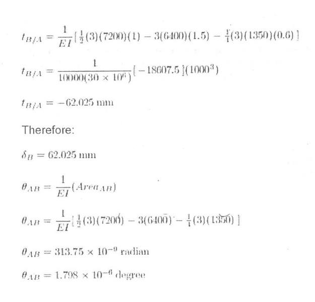

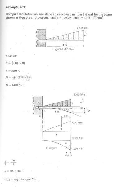

in the area-moment diagram , why the moment restricted at the wall is 0.594)(1200)(8/3 )?
I think \the 8/3 should be 1+3(2/3) , am i right ? Since we know that , the centorid of triangle is 2/3 from the right end , and the triangle has the length of 3m .. ( it's stated in the question that slope is 3m from the wall) ...
since 1+3(2/3) = 3 ,
So, M=(0.5)(4)(1200)(3) = 7200Nm?

No, the centroid of the triangular load is 2/3 from the left end in this case, where the beam is fixed and the triangle has its acute angle.

why it's 4(2/3)=8/3 ?
why not 1+3(2/3) = 3 ?
The triangle only start at 1m away from wall. so length of triangle only 4-1=3m

You might want to look more carefully at the diagram in the OP, Figure E4.10. This shows the layout of the entire beam and the load.
The unsupported span of the beam is 4 meters.
Now, the diagram below Fig. E4.10 is for calculating the slope and deflection of the beam at 3 m from the wall. However, in order to make this calculation, you must first determine the reactions R and M at the wall due to the triangular load, which is why R = (1/2)(4)(1200) and M = (1/2)(4)(1200)(8/3).
