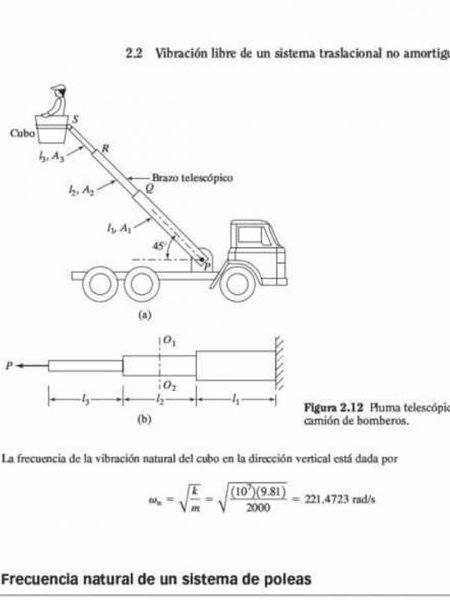

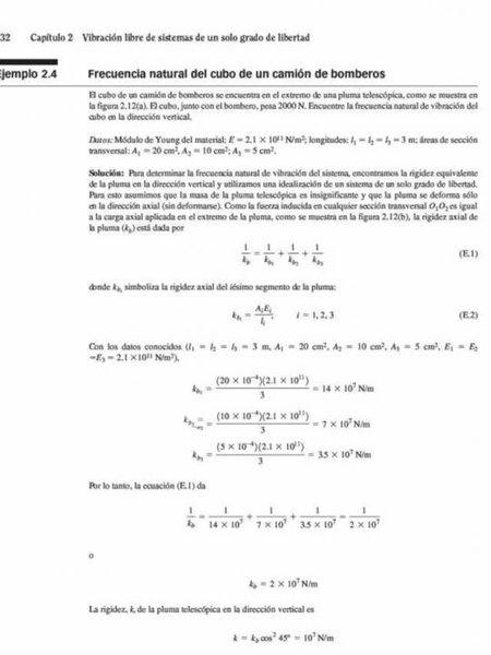

Good night guys. I've been studying for a test on mechanical vibrations and I came across this problem of a telescopic crane (or whatever its name is). It's necessary to obtain a equivalent constant kp and then it has to be decomposed into its vertical component and the author uses a squared cosine of 45 degrees to do so. I would have used a sine of 45 degrees instead without squaring it. I know the sine and the cosine have both the same result, I'm just using a sine because the vertical component is needed.
Could you please tell me why the author is using a squared cosine? Also, why is the force pulling and not pushing when the weight of the guy is obviously going downwards?

The problem statement appears to be in Spanish (or is it Portuguese?), which just about wipes me out. I can guess at what the problem is asking, but based on that, the answer given makes no sense at all. To do much better, I would suggest that you translate the problem statement into English. After that, I and probably others as well, will be able to do more to help you.
The attached PDF gives an explanation of this problem that I hope will make clear the very limited role that the boom angle plays.
As I translate it, the first section of the problem is simply a calculation of the composite kb (stiffness) for the combined three boom segments' k1, k2, k3 along the axis of the boom, ignoring the bending of the beam; with a following conversion of that linear beam kb to vertical component k. As a result, I cannot see any reason for the use of cos^2 45° rather than simply sin 45°.
