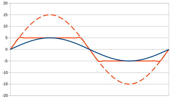

If you need a ±5 V signal, you can use a signal with a higher voltage (say, ±15 V), but limited to ±5 V, and get an approximate square wave. Is this something that could be happening here?
Graph of voltage against time over one cycle: a dashed orange sine wave peaking near 15 and dipping to -15, a solid blue sine wave peaking at 5 and dipping to -5, and a solid orange near-square wave clipped flat at about 5 and -5.
I guess what I am really asking is, without any crazy modifications, or additional electronic components, shouldn't this work? Plugging a "square wave drive" tachometer into an alternator's AC sine wave output?
I suspect this is the case, due to my oscilloscope readings that show the mag pickup producing a near-sine wave instead of a square wave as I was told it produces? I tested the parts the manufacturer said are compatible & produce square waves, and they do not produce a true square wave...
Am I right & the supplier is wrong? Will this work?

My five points were not directed at your particular installation, but at the general case. It matters not whether you care, but the manufacturer's tachometer was not designed to meet all their specifications when driven by an alternator. If it works OK, test it and use it.
My point 2. A modern automotive VR receiver would transmit a small DC current through the transducer. If that DC current did not return from the VR coil, the On-Board-Diagnostics would report an open circuit in that VR sensor circuit. A short to ground would also be reported by the diagnostics. Maybe that feature is present in the receiver IC used in the new tachometer gauge. There are unknowns we do not even know about, but the manufacturer does. When they say "use a VR magnetic sensor", they do not want you calling them to say it does not work properly with your alternator signal.
