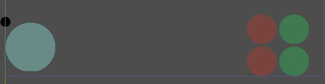

My Godot game uses a touchscreen joystick comprising of two circles. One is the touchscreen area. The other is a smaller circle to show where the player is pressing. The smaller circle is visible when I run the joystick scene on its own, but not visible when the joystick is a child node.
Hi everyone
I'm using this code for a touchscreen joystick in my Godot game:

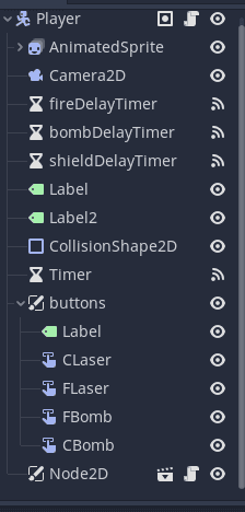

The code works for controlling the player, but the InnerCircle sprite is only visible when I run the joystick scene on its own. When I run it as a child node of Player.tscn, InnerCircle doesn't appear, although the joystick still works fine.
Godot scene tree panel for Player: AnimatedSprite, Camera2D, fireDelayTimer, bombDelayTimer, shieldDelayTimer, Label, Label2, CollisionShape2D, Timer, buttons group with Label, CLaser, FLaser, FBomb, CBomb, and Node2D at the bottom.
InnerCircle (the black dot) is visible in the editor, but not when I run Player.tscn.
Screenshot of a dark grey game scene showing a large light teal circle on the left, a small black dot at the top-left corner, and four circles on the right: two red and two green arranged in a 2x2 grid.
The same applies when I run Player.tscn as a child node of Level.tscn.
Does anyone know why this is happening? I'm stuck for ideas. I've tried making sure the joystick ("Node2D") is on top, but it's in a canvas layer, so nothing should be blocking it anyway. Thanks
