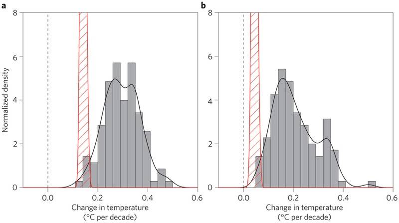

I think this is now a legitimate topic. If not, I apologize. I would like to hear comments on the paper "Why models run hot", discussed in this article. Do people on this forum agree that the IPCC models overestimate the amount of positive feedback in the Earth's climate system.? Or is this new article flawed? I've attached a pdf of the article.

This paper is so very bad that it will receive a good number of citations in the next few months by later papers that show just how bad this paper is. It is so monumentally bad that I won't be at all surprised if it makes its way onto retractionwatch.com.
First, for the claim that "models run hot." This is a false claim. The authors went all the way back to the first assessment report as the basis for their claim that "models run hot" (which they don't). Granted, that very first report had some flaws; it was the very first report, after all. That first assessment did not use tools such as general circulation models, which were in their infancy in the late 1980s. Note that this means that even if the paper by Monckton et al. is correct (which it isn't), that they target the FAR is a fatal flaw in their paper. Later assessments used general circulation models to drive the analyses. The switch to better models in later reports means that that the authors arguments apply only to that very first report.
Even with regard to that very first report, the claim "models run hot" is a false claim. The first assessment presented warming under multiple scenarios, the worst case being the "business as usual" scenario. Monckton et al. cherry-picked that "business as usual" scenario as if it were the report's sole prediction. This scenario assumed cars would continue to have 1990 gas mileage, coal power plants would continue to have 1990 emissions, and that the economy and population would continue growing. That didn't happen. There have been modest improvements in technology since 1990, populations in the developed world have gone stagnant, and the world was hit by two huge economic downturns. The world pumped less CO2 into the atmosphere than predicated by the "business as usual" scenario, so of course that scenario "ran hot."
Another flaw in the paper is their use of an 810,000 year baseline as proof that positive feedbacks don't exist. That's completely wrong. The Milankovich forcings are rather small. The slight reductions in solar irradiation that result from the Milankovich cycles are too slight in and of themselves to result in a glaciation. We wouldn't have glaciations without positive feedbacks.
The biggest flaw in the paper is the authors silly Figure 5 and the arguments around it. That a sound system designer wouldn't create a system with loop gain of more than 0.1 means that the climate mustn't have a gain greater than 0.1 is a ludicrous non sequitur.

That depends on which dataset one uses.
The table below summarizes the warming since 1990 per various temperature datasets.
Code:
Source     °C/decade
Satellite-based
RSS        0.11
UAH        0.16
Surface-based
GISTEMP    0.15
NOAA       0.14
HADCRUT4   0.14
Berkeley   0.16
One of the above datasets stands out, in a Sesame Street sense ("one of these things does not go with the other; one of these things doesn't belong"). The silly article used that singular source, the Remote Sensing Systems (RSS) dataset. So-called "skeptics" love RSS. Everyone else says "Hmm. That's funny. Maybe I shouldn't use that."
When one looks at CO2 forcings based on observed CO2 levels since 1990, the closest match is scenario B. With the exception of RSS, the observed data are most consistent with scenario B from the IPCC's First Assessment Report.
Note well: I intentionally omitted the uncertainties in the above table. The silly article did the same, so tit for tat. The uncertainties are rather large. All of the datasets are consistent with one another, to within two standard deviations.
After accounting for those uncertainties, each of those observation based datasets is consistent with each of the FAR scenarios. The uncertainties are just too large over a mere 25 year span to rule out anyone of those scenarios. The only thing that can be excluded (with the exception of RSS) is that there has been no warming whatsoever.
The RSS database exhibits the greatest uncertainty. It is consistent with both "business as usual" and "no warming whatsoever." The null hypothesis, "no warming whatsoever," is easily rejected by all but the RSS database.
This seems to me to be the most important piece of information to keep in mind.
