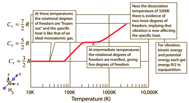

when i searched on the internet for Cv and Cp for diatmoic gas i found it to be 5/2 R
and i don't know why they consider the transitional and rotational motion only for the degree of freedoms and why they neglect the vibration motion i think it should be 7/2 R for Cv and 9/2 R for Cp
The Equipartition Principle applies only at temperatures where the thermal energy KBT is well above the excitation energy of the vibrational mode of the molecule. The energy of vibration motion of two-atomic molecules is in the range 0.2-0.5 eV.
See
ehild

Basically, what they are saying is "Ignore Quantum effects" And then you have 5 degrees of freedom. So then you have to use 5/2 instead of 7/2. Basically, it's just to save you time.
?? There would be 7 degrees of freedom if one was to "ignore quantum effects". The Cv of an ideal diatomic gas is 5/2 except at very low and very high temperatures BECAUSE of quantum effects (e.g. the "freezing out" of vibrational modes except at very high temperatures), as shown in ehild's excellent chart.
