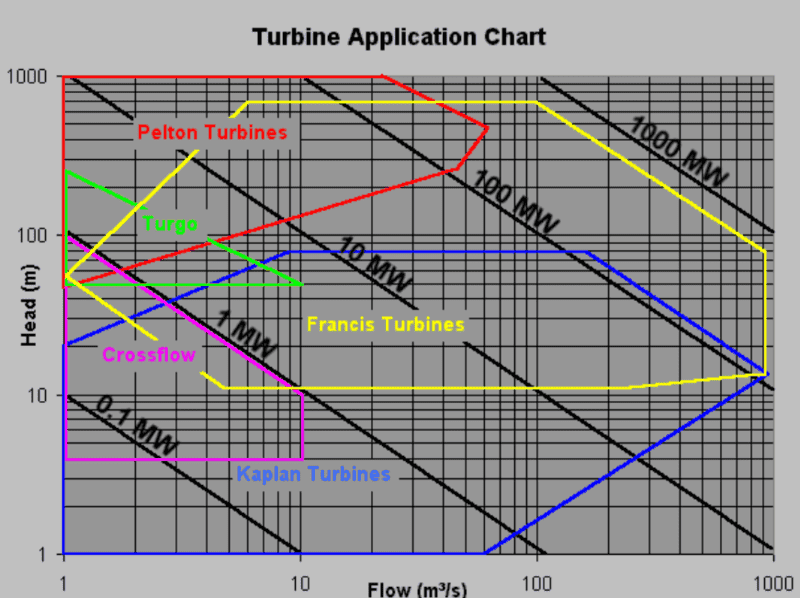

Where would you place existing designs of positive displacement turbines on this diagram?
I don't know. I'm just asking a question.
But if i would have i guess i would think relatively high head and low flow.
Maybe it is good for micro hydro turbines with high head because you don't have to optimize the nozzle design for a pelton, and don't need the complex geometry of a francis, and you don't need the pitch mechanism of a kaplan. So a lobe turbine would maybe be simpler and cheaper to make for a small scale personal hydro plant.
Here's a calibration. The left hand border of that diagram is a flow of 1 m3 per second. That is 15380 gallons per minute. Most positive displacement pumps operate 1-2 decades to the left of that.
Positive displacement pumps and turbines have fluid chambers with fixed volumes. Therein lies the problem, with the seals between chambers and the surfaces in sliding contact. Gear motors and pumps are positive displacement systems that are almost always lubricated by the fluid they contact, such as hydraulic oil.
Over the last 70 years, positive displacement piston engines for aircraft have been largely replaced by high reliability gas turbines. Contact between solid materials, such as piston ring pressure against the cylinder walls, has been eliminated. The operating fluid now fills the clearance between the moving parts.
Progressive-cavity-pumps, such as worms, screws, and blowers, are often used with incompressible water, or compressed air. Those engines tend to have elastomer seals that are damaged by fluid contamination. Where inverted for use as motors, they would require higher maintenance, and so would rapidly be replaced by the more reliable flow turbines. That is where we are today. Why might anyone want to go backwards?
