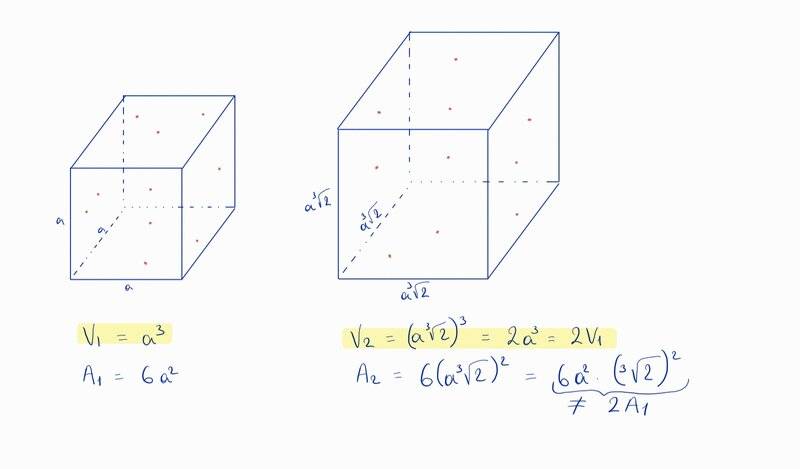

Viewing pressure as force per area, not the frequency of collisions. Can someone explain the reason why pressure stays the same when doubling both the volume and the temperature.
In thermodynamics we tend to think of pressure as the frequency of collisions with the walls of the container. And we say that the more the collisions the higher the pressure, the less the collisions the lower the pressure.
So lets say we have an ideal monoatomic gas enclosed in a cube container. According to the ideal gas law: PV = nRT, if we double the volume and the temperature then the pressure will remain the same
P = nRT / V
P= nR2T / 2V
And the explanation for that is that the number of collisions per second stays the same. Now the atoms have double the kinetic energy but they also have the double space to move into. So, that makes sense when viewing pressure as the frequency of collisions with the container walls.
But what if i were to think about pressure as the total force exerted over the total (inside) area of the cube?
When doubling the temperature the kinetic energy also doubles, so what happens to the forces of the collisions, do they also double? If they do double then the area should also double in order for the pressure to remain the same, But that doesn't happen, doubling the volume of a cube doesn't double the cubes total area.

Let the initial box have size ##L\times L\times L## and contain ##N## atoms which have RMS velocity ##v##. Each atom collides with average frequency ##v/L## and transfers momentum ##2mv##, for a total momentum transfer per unit time (i.e., total force) to the wall of ##F=2Nmv^2/L## and hence a pressure over the wall of ##P=2Nmv^2/L^3## (edit: corrected missing ##N## - see next post).
Now let the temperature and volume double. The box's side length is now ##L'=2^{1/3}L##, and the kinetic energy per atom doubles so the new RMS atom velocity is ##v'=2^{1/2}v##. The number of atoms is unchanged. Now each atom collides with average frequency ##v'/L'## and transfers momentum ##2mv'##, for a total momentum transfer per unit time (i.e., total force) to the wall of ##F'=2Nmv'^2/L'## and hence a pressure over the wall of ##P'=2Nmv'^2/L'^3## (edit: corrected missing ##N## here too). But ##v'^2=2v^2## and ##L'^3=2L^3##, so ##P'=P## as expected.

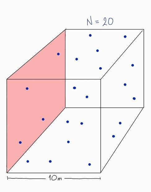

Thank you for your patience, i still can't fully understand your explanation so let me give you a way too simplified numerical example, so i can be sure i get what you are saying.
Once again: ideal gas enclosed in cubic container(10meter side). Each atom has velocity 5m/s and when it hits the wall, it stays in contact for 0.5 seconds (Our only assumption is the duration of collision)
So for an atom to travel straight from one wall to the other and then bounce back takes 2.5 seconds, two seconds to travel 10m and 0.5 seconds during the collision.
And obsiously this holds true for all 20 atoms.
So assuming the duration of collision to be 0.5 seconds how can you find out how many atoms hit the red wall?
According to your logic: 0.5s is the one fifth of 2.5s , so one atom spends one fifth of its time in contact with the wall, while the other four fifths the atom travels be tween the walls.
So for a half a second atoms will be in contact with the wall, then half a second passes these atoms have left and new atoms are now in contact with the wall.
Now, the question is how many atoms hit-stay in contact for 0.5 s with the red wall, every 0.5s ?
Your answer: 0,5N = 0.5 * 20 = 4 atoms
....and i don't understand. Why should we multiply 0.5 times N? All we know is that for every 0.5 seconds new atoms will be in contact with the wall. Why should it be 4 atoms? Why not 2 atoms every 0,5 sec? Or why not 5?
Thank you, and I'm sorry for troubling you😟
lost captain said:
So for a half a second atoms will be in contact with the wall, ...
The wall contact duration is completely irrelevant. All you care about is the average momentum transfer rate over many collisions (force).
