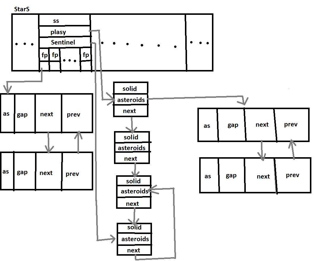

It has to look as followed:
So could we write it as you did in the post #42?? (Wondering)
Aha! (Smile)
Yes.
It fits either way. (Thinking)
