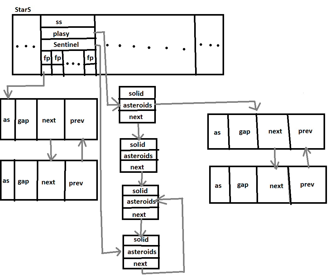

Ahaaa... I see... (Star)Then I have to write also an other function for the constitution of an asteroid with identifier "as" at the planetary system "solid".
"gap" is the gap between the new asteroid and the object.
The new asteroid should be added in the appropriate position, in respect of the "gap", in the list of asteroids.
The field gap, that corresponds to the new asteroid, contains the gap from the previous asteroid in the list of asteroids and not the gap from the object.

What is [m]Sfreep[/m]? (Wondering)
What if [m]q[/m] is NULL? (Wondering)
Shouldn't the asteroid after the new one have its [m]prev[/m] updated? (Wondering)

  • #67
mathmari said:
[m]Sfreep[/m] should be replaced with [m]nrStarS[/m] (Blush)
We have initialized [m]q[/m] as followed
[m]asteroid_t *q=p->asteroids;[/m]
right?? (Wondering)
That is at first, but you never use it like that.
So you might as well not initialize it, or initialize it to NULL. (Nerd)
In the else statement [m]p[/m] is not NULL. So, can [m]q[/m] be NULL ?? (Wondering)
When you do give [m]q[/m] a value in [m]q=ast->next[/m], it can be NULL. (Shake)
Could I maybe do it as followed?? (Wondering)
Code:
ast->next=last->next;
last->next->prev=ast;
In principle, yes, but what if [m]last->next[/m] is NULL? (Wondering)
Code:
q=ast->next;
q->gap=q->gap-ast->gap;
What if [m]q[/m] becomes NULL here?
Then you are following a NULL pointer to madness and chaos! (Evilgrin)

We should distinguish 2 cases with an [m]if[/m], or actually 4.
It can be that "ast" has to be inserted before the first element of the list, and it can also be that "ast" has to be appended after the last element of the list.
These cases require special handling. (Sweating)

Almost there! (Smile)
In the regular case, 4 connections need to be made (2 next, 2 prev).
I only see 3 connections. (Wasntme)

		StarS[i].ffplan[i].fp=INT_MAX;
		StarS[i].ffplan[i].ff=NULL;
Let's start with this. (Worried)
There should be a nested loop to iterate over [m]ffplan[/m], for instance with the index [m]j[/m].
Otherwise, we're not initializing everything, and moreover, we'll likely get an access violation. (Devil)
Code:
int Constitution(int ss) {
11.        starsystem->plasy=starsystem->Sentinel;
17.}
At the line 11 of the function Constitution() we set [m]starsystem->plasy=starsystem->Sentinel;[/m] but at the function Initialization() we set [m]StarS.Sentinel=NULL;[/m].
Should we maybe change the value of [m]starsystem->Sentinel[/m] in the function Constitution()?? (Wondering)
Because in that way we set [m]starsystem->plasy[/m] to [m]NULL[/m].
Yep.
The [m]Sentinel[/m] is handled the wrong way. (Worried)
It is supposed to be a pointer to the last element in the list, which initially does not exist.
We should set both [m]plasy[/m] and [m]Sentinel[/m] to [m]NULL[/m] (or leave them as NULL). (Wasntme)
  • #85

        plansystem->solid=solid;
        plansystem->asteroids=NULL;
        plansystem->next=NULL;
		for(i=0; i<Sfreep; i++){
			if(StarS[i].ss==ss){
				k=i;
				if (StarS[k].plasy == NULL) {
                     /* List is empty: replace with new plansystem */
                     StarS[k].plasy = plansystem;
                     StarS[k].Sentinel=StarS[k].plasy;
                } else {
                    /* Find last node */
                    plansys_t *last = StarS[k].plasy;
                    while (last->next != NULL) {
                          last = last->next;
                    /* Append new plansystem to the last node */
                    last->next = plansystem;
                    last->next->Sentinel=last;
		return k;
(Wondering)
I like Serena said:
Hmm, it would help if there were some consistency to the indentation... (Wink)
What do you mean?? (Wondering)
  • #90
mathmari said:
Is it maybe as followed?? (Wondering)
The first is correct! (Smile)
But the second is not. (Worried)
Sentinal is a data member of StarS[k], and not of last->next.
You should set StarS[k].Sentinal to last->next, which is by now the same as plansystem.Alternatively, you could do at the end: [m]StarS[k].Sentinal = plansystem[/m].
That works because [m]plansystem[/m] is always added to the end, wherever that is. So afterwards it is the last node in the list, which is where [m]Sentinal[/m] should point. (Nerd)
The way the code is indented, it is hard to follow the flow of the program, and understand if and where something is wrong and should be changed. (Sweating)
Better is:
Code:
int Beginning(int solid, int ss){
    int i, k = -1;
    /* Add a planetary system to the list of the planetary system of the star system */
    plansys_t *plansystem = calloc(1, sizeof(plansys_t));
    plansystem->solid = solid;
    plansystem->asteroids = NULL;
    plansystem->next = NULL;
        if(StarS[i].ss == ss){
            k=i;
                StarS[k].Sentinel = StarS[k].plasy;
            } else {
                    last = last->next;
                last->next->Sentinel = last;
    return k;
Like this it becomes clear where the for-loop starts and ends, where the first if-statement is, and where the nested if-else statement is (and that there is one). (Whew)
