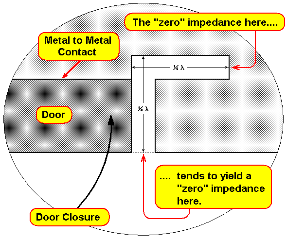

Hill said:
Nothing like it on my oven door (LG). Just flat plastic to metal surfaces.
They all look different because the plastic / rubber is not a major part of the filter. Under the strip there is a slot in the metal, hidden from view. Obvs it must be better not to have exposed grooves in the plastic as there's no room to accumulate grot.
This diagram shows the basics of how the slot in the flange works. It's the clever way a transmission line acts as a transformer. the top right has a blank end (short circuit) which is transformed into an open circuit at the knee, half way along and then back to a short circuit across the gap between the door and case (at the microwave frequency) Waveguide couplings use a similar method to avoid signal leakage in and out at a join.
