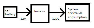

Im trying to calculate if a standard car battery will be able to run 2 computers, 2 monitors, and some small hardware, and if so, for how long.
The entire configuration should be no more than 1000watts. (400 each computer, 50 each monitor, and 100 for small hardware). I can't seem to find how many watts a car battery will output.
Since car batteries are 12v, Ill have to run everything through a transformer (12v -> 120v, 1000watts stable).
Any help would be strongly appreciated.

Sorry, yes its a 12V DC -> 120V AC inverter (1000 watts). What if the car is running, would it be able to charge the battery faster than the system will discharge it?
By Ohm's law, 1000W at 12V means a current of 83 amps. A typical car battery has a capacity of about 40 amp-hours, so it would run the system for less than half an hour. Given the high current involved and the losses in the inverter, maybe only 15 minutes.
If the car engine is running, the output from the alternator would probably be of the order of 100 amps, but only if the engine was running faster than idling speed. But if you compare the the cost of fuel with the cost of mains electricity, that would be a very expensive way to power the system. If you want to go that way, buy a portable generator with a small IC engine that is designed for the job. That would be much more efficient, and reliable, in the long run, than using a car engine and alternator that were designed to do something very different.
I see, I was calculating 1000W at 120V, I see where my mistake was. The problem is I need these to run for 12 hours continuously, and I need them to be portable, (inside a car).
It's like that, would that be 1000watts at 120v or at 12v?
if its at 120v then its 8.3 amps which is very little and a battery should be charged faster than depleted. If it's at 12v then its 83Amps which is too much.
Computers also run on DC. The power supply typically converts the wall AC to something like +-12V, +-5V. So you may be able to avoid the inverter if you hack your own power supply.
Neglecting inefficiency in the inverter, the battery supplies 1000 watt at 12 volt.

The load is 1000 watts at 120V, but that means the battery also supplies 1000 watts, just at 12V. Plus losses, of course.
