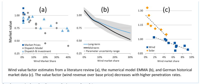

Several factors include curtailment of wind and solar (throwing away extra, i.e no return) and the marginal cost or running dispatchable power plants (ie gas) that *must* be in the grid without storage.
Wind for instance devalues to about 85% of its original value at 10% grid share. Solar devalues much faster.
View attachment 204029https://thebreakthrough.org/index.php/voices/energetics/a-look-at-wind-and-solar-part-2
This is telling me that as we get more and more solar PV, it has to be come cheaper just to keep up.
Getting to ~ 4% solar from where we are now (sub 1%?) means you might get ~ 75% of the income you would expect today.
