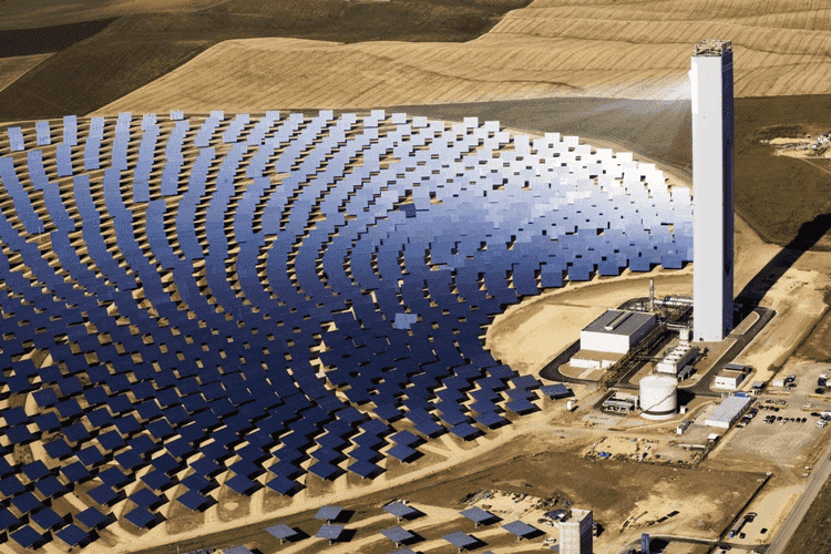

Tom.G said:Like this, perhaps? For a sense of scale, see the cars in the parking lot at lower right.
That is Solar One in the Mojave Desert (California). It was retired in 1988. This is a Solar Thermal unit. The top of the tower, operating at 1000°F, has molten salt circulating in it as a thermal transfer fluid. Then water is boiled to drive a conventional steam turbine/generator system.
Photovoltaic cells are destroyed at those temperatures.
Solar Two and a bit more info at:
https://www.atlasobscura.com/places/solar-one-and-solar-two
Also:
https://climatekids.nasa.gov/concentrating-solar/
But they are V-E-R-Y slow to connect, it may take a few tries.

Hmm I see the issue, I am going to have to study ambient lighting a little bit more and get back to you.mfb said:@paradisePhysicist: With PV this is generally known as concentrator PV. You save some PV area but you increase the complexity of the system, you generally need tracking to follow the Sun, you create heating issues, and it only helps with direct sunshine - on cloudy days your mirrors are not brighter than the sky they obstruct.
However the design you mentioned is not my design, I will draw my design here.
basically the sun shoots a cone of light at earth. (Really the sun emits a sphere of light but only a cone of it hits earth.) With normal solar panels the only part of this cone you are getting is the surface area of the solar panels+ambient light. But with this invention you get more than 10x the amount of light you get normally.
Mirror-like materials can be cheap, we can use mylar foil as cheap mirrors instead of real and expensive mirrors.anorlunda said:The economics are changing so fast. I suspect that we are already at the point where the cost of one square meter of mirrors is about the same as one square meter of PV panels.

Have you estimated or calculated how hot the surface of a solar panel will get with a 10x concentration of sunlight?paradisePhysicist said:... But with this invention you get more than 10x the amount of light you get normally. ...
Have you studied the effect that temperature has on solar panel efficiency?
Do you know the maximum temperature a solar panel can withstand before it is damaged?
paradisePhysicist said:... Mirror-like materials can be cheap, we can use mylar foil as cheap mirrors instead of real and expensive mirrors.
Yes, but you need frames to hold them, and you need to protect them from wind, animals, etc. I don't think mylar film will stand up to much wind.

The PV cell efficiency decreases with temperature - it looks like the maximum boost runs about 40% unless the PV is actively cooled.
The elevated temperature will probably not kill the PV outright, however all aging related effects are also accelerated at the higher temps.
There are some more novel PV technologies that would do better with the higher temps - but all of this is driving the price and complexity up.
