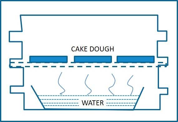

I am planning to make some rice cakes which is prepared by steaming a mix of rice powder and water. Because I don't have the special cooker used for that at my current location, I though of using the electric oven in my house. While google search tells me it is possible to use oven as a steamer, I am a bit scared of two reasons:
1. The procedure in my mind is by placing the dough and a tray of water inside the oven (shown in pic.):
Once the oven starts generating steam, will it not create a high pressure inside? This looks more like a pressure cooker to me. How do ovens handle this extreme force? I see the front door is made of glass.
2. The steam generated will settle on the walls and ceiling of the oven. Does it cause any problem to the oven. Once cooled down, they will drip down as water. Is there a draining system?
Not a good idea, in my opinion.
The dough will receive radiation heat in addition to any cooking effect from 100°C steam.
Not sure how well isolated from the steam the electrical staff is.
Pressure may build up inside the cavity.
No place to go for condensation.

Radiation is not wanted here. I agree that this is a bad idea then.
What about those stovetop bamboo steamers which sit on top of a pan of water, like you make Chinese dumplings with?
No idea what kind of the oven you are talking about, but unless it is really airtight when closed there is no way for the pressure to go up. Most ovens I can think of will just freely release the steam long before any real pressure builds up.

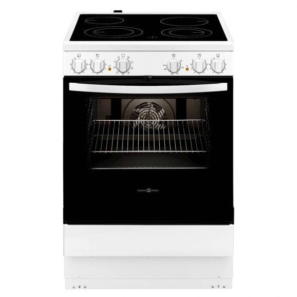

Can you post a picture of the oven?
In most cases there are no vents nor anything like that, as the lid itself is not even remotely airtight, nor is the case. Trying to pump up typical oven is a bit like using colander to carry water, plenty of small holes and leaks that won't let to keep the gas in.

If this is a normal oven, it is not a sealed pressure vessel. It is incapable of holding pressure. The extra air/steam volume simply escapes through the door seam.
Try this exercise:
-Pull on the door handle. Estimate the force it took to crack open.
-Divide by half the area of the door to get the pressure. You'll see it is tiny.
For condensation, it should not be an issue because the steam is being generated slowly and shouldn't cause the humidity to be high enough for condensation on the hot, insulated walls.

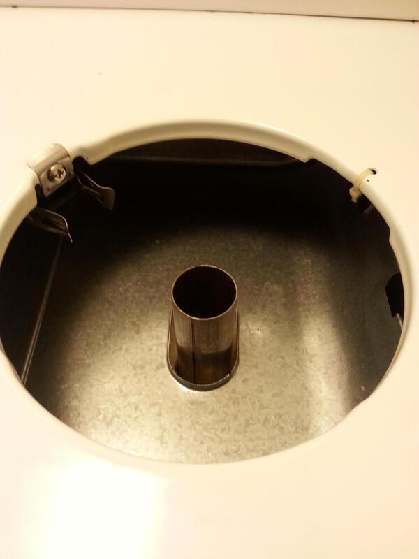

I have never seen an oven that is not ventilated. For example:
Is that an electric? Clearly a gas oven needs ventilation, but I can't think of a reason to ventilate an electric oven.
Yes, electric. See
There is a sealing gasket on the oven door, but it's not airtight.

Hmm -- air circulation for uniform heating. Interesting. I wonder if that applies to convection ovens too (probably, if they can operate in a non-convection mode).

I have a convection oven and it is ventilated, not as in the picture above, but through a dedicated vent near the back of the top, the black thing you can see in this picture of a similar model:
