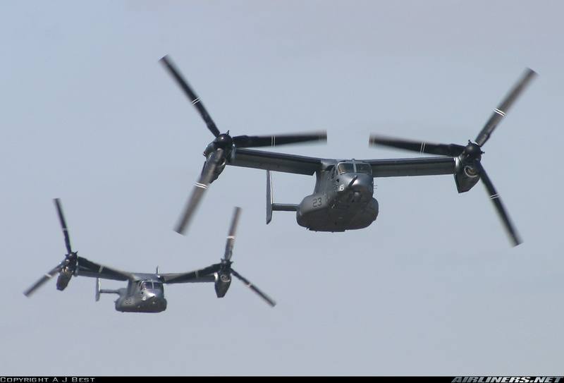

Hello all,
I am curious about other peoples opinions on the future of tilt-rotor aircraft such as ospreys. I would like to know if anybody thinks they stand a chance of over taking helicopters in civilian and or military use.

that looks quite cool
but this is more what i had in mind
