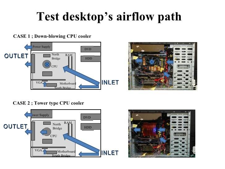

Can you post a picture of your motherboard and anything else inside the computer box? There will be preferred places to put a fan or fans. Also, if the PC you are basing this on has a fan, you should probably just duplicate the position of the fan in your box...
And does your power supply module already have its own exhaust fan built-in?
https://www.slideshare.net/JeehoonChoi/thermal-and-airflow-modeling-methodology-for-desktop-pc

Just a tip.. larger diameter fans are quieter than small ones for the same airflow rate.
