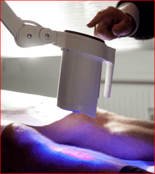

Hi all,
I came across a device named: Wireless Microcurrent Stimulation used in medical applications and more particularly in wound healing. I am just trying to understand how the device works from an electromagnetic engineering perspective.
More details: https://www.ncbi.nlm.nih.gov/pmc/articles/PMC7950994/
https://www.wetlinghealth.com/wp/wireless-micro-current-stimulation-wmcs/
1. Does it radiate an electromagnetic field? If yes, does it induce the current of injury via a DC electric field?
2. If it's a DC electric field, then it must be an electrostatic type of charge.
I would appreciate anyone's thoughts on this one.
Thanks
G
Welcome to PF.
The instrument appears to "illuminate" the wound with ionised atmospheric molecules from a non-contact ion generator. The ion generator may be an enclosed short wavelength UV lamp, or a high voltage air discharge.
There is no radio frequency EM involved. It is wireless because the wound site has no contact electrode.
The wrist-strap ground-reference is the only conductive contact. The potential of the ion generator is selected to electrostatically drive a greater proportion of the ions to the wound site.

TL:DR
Yes it is a DC current of some polarity generated by a repetitive spark arc on a short sharp pin that ionized the air with power RGB LEDs with current measurements being unspecified, how, where and what.
It would most certainly generate an Electric Field if an electric current is generated but little is known about the transfer function of the uA current measurement.
This is the device used in your article by a company in Denmark.
All I know is that it generates light with RGB LEDs in the datasheet with some unknown quantity of ionized air.
This is copied from one of their patents.
"[0044] The ionized gas molecules (also termed "air ions") are hence conveniently provided from a gas ion transmittingdevice, which includes a gas ion generator (also known as an "air ionizer"). This type of device is known to the skilledperson and is e.g. used in the semiconductor industry to counteract electrostatic charge building when handling andtransporting microchips and wafers. However, a suitable gas ion transmitting device for use in the present invention isone which, apart from generating the ions, is capable of delivering a directed stream of gas ions having either a predominant positive or a predominant negative charge (where e.g. the devices used in the semiconductor industry typicallydeliver a balanced mixture of positive and negative ions).[0045] In brief, such an apparatus generates a high voltage applied to an electrode, which thus produces an electricfield that is most intense in a defined region (e.g. immediately adjacent a sharply pointed tip). The intense electric fielddisrupts the normal charge state of molecules of air gases (e.g. nitrogen and oxygen) in the region adjacent to the sharplypointed tip and some of the molecules become negative or positive ions, depending upon whether the molecule attainsan excess or a deficiency of electrons (typically oxygen will become negatively charged, whereas nitrogen will becomepositively charged). The ions having a polarity opposite from the polarity of the high voltage of the electrode are attractedto the electrode and are neutralized, whereas ions of the same polarity as the high voltage electrode are repelled by theelectrode and are dispersed outwardly. The subsequent projection towards the treated object with the thus generatedair ions can be controlled when the receiving object is connected to a discharge electrode of opposite or neutral polarity(i.e. a ground electrode), which will ensure a correct projection of the ionized gas molecules in the desired directiontowards the target area. Also, such a discharge electrode can be equipped with an amperemeter or other device formeasuring the current passing through the electrode whereby the dosage of the ionized gas molecules can be controlledby a feedback mechanism where gas ion generation and projection is controlled in response to the current passingthrough the discharge electrode (i.e. if the current exceeds a preselected current, the amount of gas ions projected bythe ionized gas transmitting device is downregulated, and vice versa)."
