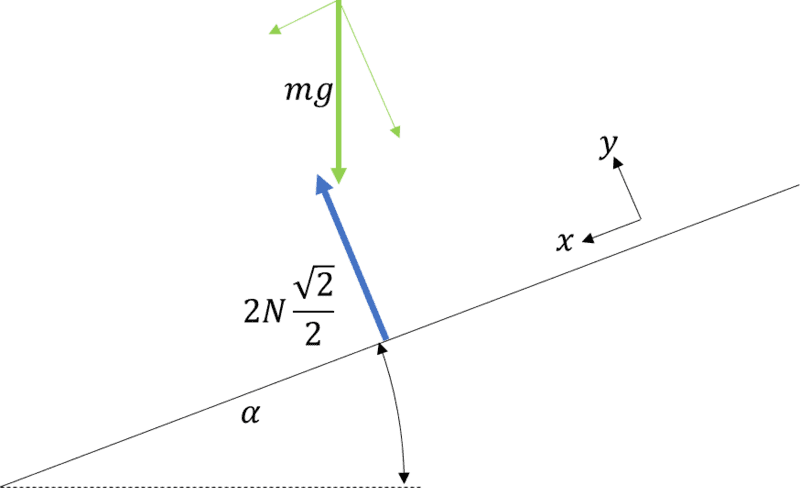

I don't know how to do it. You said that the vertical components of the normal forces must balance the perpendicular weight ##mg cos \alpha##. So, what is wrong in my equation should be the expression of ##N##, right? Would you have more in-depth hints on how to write it?
  • #32
Hak said:
I don't know how to do it. You said that the vertical components of the normal reaction must balance the perpendicular weight ##mg cos \alpha##. So, what is wrong in my equation should be the expression of ##N##, right? Would you have more in-depth hints on how to write it?
The component of weight is in the plane of the page. The normal force is pointing into the page at a 45 degree angle. It is only the component of ##N## parallel to the plane of the page which balances the component of weight...not the entire magnitude ##N##.
  • #33
Yes, you're right. ##N \sqrt{2} = mg cos \alpha## is correct actually?
  • #34
So, is the correct solution ##\mu_{min} = \frac {2 \sqrt{2}}{9} tan \alpha?##

No. Where does ##\cos\alpha## come from? Look at the picture in post #26. Points ##A##, ##B## and ##O## are all in the same plane. In that plane are also the normal force vectors and the weight.

So, I would say ##N \sqrt {2} = mg##. Correct?

It seems to me that there are two different versions regarding this point. What should we do?
  • #41
  • #42
erobz said:
I thank you very much, but could you show me (only if you want) how, through triangles and angles, we arrive at the ##N \frac{\sqrt{2}}{2}## component of each normal force? Just to confirm.
  • #43
On the left we are looking up the incline. I'm not drawing to scale, and I didn't draw the other normal force.
  • #44
Thank you so much, it seems correct. I did not understand, therefore, @kuruman's answer...
  • #45
Hak said:
Thank you so much, it seems correct. I did not understand, therefore, @kuruman's answer....
Well there has been much back and forth about this now about your own confusion on this point, and you never put in a FBD showing your coordinates. I completely understand the confusion.
