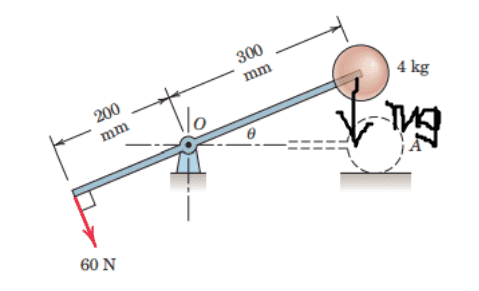

The 4-kg ball and the attached light rod rotate in the vertical plane about the fixed axis at O. If the assembly is released from rest at and moves under the action of the 60-N force, which is maintained normal to the rod, determine the velocity v of the ball as approaches . Treat the ball as a particle.

200mm = 0.2m; 300mm = 0.3m
s = 0.2(π/2) = 0.1π
T1 = 0
T2 = U1-2 = 60(0.1π) + mg(0.3) = 30.622J
v = ((2*30.622)/4)0.5 = 3.91 m/s but my answer is wrong
  • Diagram of a rod pivoted at point O with a 200 mm arm on the left carrying a 60 N force arrow pointing downward and a 300 mm arm on the right ending in a 4 kg ball; angle theta is marked at the pivot and the ball is shown raised at the right.
I am not following your symbology. But it looks like you took the work done (force tangent to circular arc, multiplied by distance traveled), then you add that to the increase in gravitational potential energy and equate that to the kinetic energy?
What is the net energy input? What is the change in system energy? Those two must equal each other.
What is the energy input? What is the change in system energy? Those two must equal each other.
In my textbook, U is work and T is kinetic energy. I just figured out I was supposed to subtract the work done by gravity, not add.
