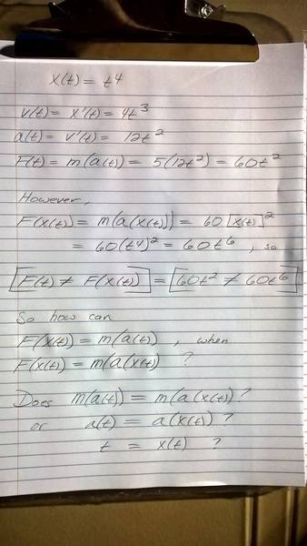

Does this derivation:
...imply:
My best guess is that x(t) ≠ t
So I would also guess that F(x(t)) ≠ F(t)
But then how can this derivation be explained?
How can F(x(t)) = m(a(t))? What does that actually mean?
How come it's not: F(x(t)) = m(a(x(t))) ? Why/How does the x just cancel out? Thank you
Would this question be better suited for the math section? If so, please feel free to transfer it. It seems to be bordering on a math related question within a physics derivation and I don't think I'll fully understand the derivation without understanding how the math is being work at this part.
Again, thanks.

The following might describe more precisely where I'm experiencing some uncertainty,
Suppose I start with some object of 5kg moving in some way described by x(t) = t^4, then:
Why do I arrive at 60t^2 for f(t)
and arrive at 60t^6 for f(x(t))?
It seems like f(t) = 60(t)^2
while f(t(x)) = f(t^4) = 60(t^4)^2 = 60t^6

In your example, you went wrong in the step where you wrote $$F(x(t)) = m(a(x(t))) = 60[x(t)^2]^2$$ The first equality is correct, the second is not. The problem is that ##a(t)## and ##a(x)## are different functions: the first is the formula you use to calculate the acceleration at a given time and the second is the formula you use to calculate the acceleration when the object is at a given position and is not equal to ##12t^2##. Whenever you see ##a(t)## you are allowed to substitute ##12t^2##, but you cannot make the same substitution when you see ##a(x)##.
The same is true of ##x##, ##v##, and ##F##; for example ##x(t)=t^4## but ##x(x)=x##.
If you work through your example again but use different names (for example ##F_x(x)## and ##F_t(t)## for the force) for the functions of time and of position it will all come out consistently.

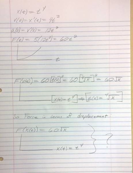

Thank you,
If I were to look at each function graphically, I have something like this:
However, I'm having some difficulty in figuring out how to express the force as a function of distance.

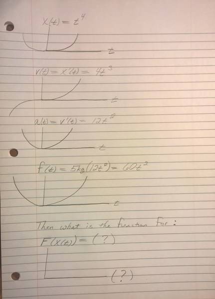

From starting with a displacement as a function of time: x(t) = t^{4} and arriving at a force with respect to time: f(t) = 60t^{2}
How can I take it one step further and find a function of force with respect to displacement? F(x) or F(x(t)) ?

Well, first we introduce a dimension-correcting factor B (with dimension m/s4), so that x(t)=Bt^{4}. For x≥0, this is one-to-one, so t=(\frac{x}{B})^{-4}.
Thank you Svein. I've continued to look into this and have made good progress. I must go on a tangent and ask a new question regarding momentum before coming back to the topic of kinetic energy. To be continued...
