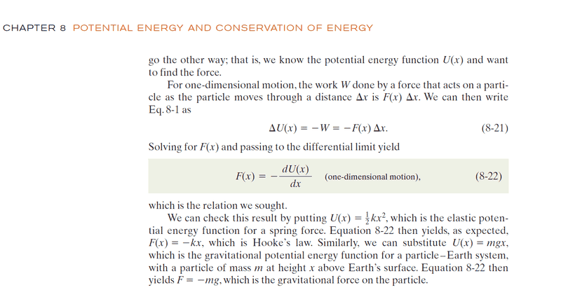

Hi, Everyone! This is the page(first image) from Principle of physics by resnik.
I want to ask the definition of work(##W=F(x) \Delta x##) by variable force here is somewhat different from the usual integral version. I don't understand how is this valid definition?
Secondly, how did they reach to the derivative F(x)=-dU/dx by limit?
(There is another approach to proving this by taking potential energies and differentiating them which results in the field force involved. This is given in my another book which is to understand(second image)).

This is indeed a bit confusing. At best the conclusion is valid for 1D motions along a fixed "##x## axis", because you can define
$$V(x)=-\int_{x_0}^x \mathrm{d} x' F(x').$$
Supposed ##F(x)## is continuous, then ##F(x)=-V'(x)##, i.e., the force ##F(x)## always has a potential.
This doesn't hold true for 3D motion/forces. There the existence of a potential is constraining the kind of forces more. In this case you must necessarily have ##\vec{\nabla} \times \vec{F}=0## if there's a potential such that ##\vec{F}=-\vec{\nabla} V##. If this constraint is fulfilled within a simply connected region of space, then there's a potential, and it's calculated by taking the line integral from any fixed position ##\vec{x}_0## to the point ##\vec{x}## within this region along an arbitrary path, and the potential is independent of the choice of this path.

If ##U(x)## represents potential energy and the work done by a position-dependent force is ##F(x)dx##, then $$\int_a^b F(x)dx = KE(b) - KE(a)$$I.e. the integral represents the change in Kinetic Energy. Then, by conservation of total mechanical energy (KE+PE) that integral must also be the negative change in PE. So that $$\int_a^b F(x)dx = U(a) - U(b)$$ And now we can apply the fundamental theorem of Calculus to get $$F(x) = -\frac {dU}{dx}$$
PS note that this only defines the potential energy up to a constant as the derivatives of ##U(x)## and ##U(x)+ U_0## are equal.

You just need:$$E = KE + PE$$ where ##E## is constant. That is conservation of total mechanical energy.

Just by definition you have
$$U(x)=-\int_{x_0}^x \mathrm{d} x' F(x') \; \Rightarrow \; F(x)=-U'(x).$$
Now you use it in the equations of motion
$$m \ddot{x}=-U'(x).$$
Multiply with ##\dot{x}## you get
$$m \dot{x} \ddot{x}=\frac{m}{2} \frac{\mathrm{d}}{\mathrm{d} t}(\dot{x}^2) =-\dot{x} U'(x)=-\frac{\mathrm{d}}{\mathrm{d} t} U(x).$$
Combining both sides of the equation gives
$$\frac{\mathrm{d}}{\mathrm{d} t} \left [\frac{m}{2} \dot{x}^2 + U(x) \right]$$
or, integrated,
$$\frac{m}{2} \dot{x}^2 + U(x)=E=\text{const}.$$

In the work-energy theorem, you can separate the work done by conservative forces, which allow for potential energies, from the work done by non-conservative forces, which don't, i.e.,
$$\Delta KE = W_c + W_{nc}$$ Because the work done by conservative forces only depend on the endpoints, we move it over to the lefthand side of the equation and introduce the concept of potential energy.
$$\Delta KE + \underbrace{(-W_c)}_{\Delta U} = W_{nc}$$ So ##W_c = -\Delta U## is pretty much a matter of definition.
