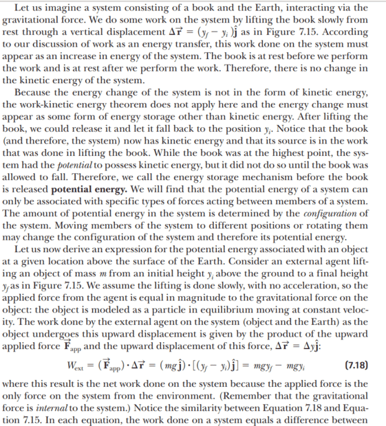

For this,
From the work kinetic energy theorem, if we assume that the book and the earth is the system, and that the finial and inital speed of the system is zero, then is the work KE theorem there is no net work done on the system. However, clearly there is work done on the system is shown by equation 7.18. Can someone please explain this paradox?

As the text explains, sort of, the work KE theorem applies to rigid bodies. It does not apply to a system which can convert some of the work performed on it into internal energy.

Sorry I not sure if I understand. If I assume that the book is a rigid object, then according to textbook, the work done on the book is ##W_{ext} = mg \Delta h##. Assuming that the finial and inital KE of the book is zero, then according the the Work KE theorem, the ##W_{ext} = \Delta {KE}##. However, this contradicts ##W_{ext} = mg \Delta h##. Do you please know why that is the case?

The text is missleading. The work energy theorem works for this case as well for systems of objects, even if the system is not rigid. It just has to be formulated properly. In this case, if the change in kinetic energy is zero, net work is zero, as predicetd by the work energy theorem. For non-rigid objects, the net work means all the work done by both external and internal forces (for rigid bodies the work done by internal forces is zero). The potential energy may or may not be brought into the picture, but the work-energy theorem holds anyway. If you want to consider potential energy, then you may use some other relationship and not the work-energy (some books calls is conservation of energy even if there are non-conservative forces) but not because the W-E does not "work". It is just a matter of choice.

But the system defined in the text is Earth+book, which is not a rigid body.
If we redefine the system as just the book then gravity acts on it, making the net force zero.

Consider just the book. Initially it is placed at rest at height ##h=0##. Then an upward force ##F## (say, from a piece of string or something) is acting on the book (let positive direction be upwards). If ##F > mg## then the book will start to travel upwards, i.e. its displacement will be positive. Let us assume this discplacement is ##h##. Total work performed on the book is ##W_\text{tot} = (F-mg)h## (because there are two external forces acting on the book).
Now, as you said, the work-energy theorem states that the total work performed on a rigid object is the change in kinetic energy. We thus have ## (F-mg)h = \dfrac{m}{2}\left( v(h)^2 - v(0)^2 \right)##. We can rewrite this as ## Fh = mgh + \dfrac{mv(h)^2}{2} ## (using ##v(0) = 0##) and identify ##mgh## with gravitational potential energy. The work performed by the force ##F## has in this case increased the potential energy of the book, and also its kinetic energy (if ##F = mg## then ##v(h) = 0## too and we have just increased the potential energy.)

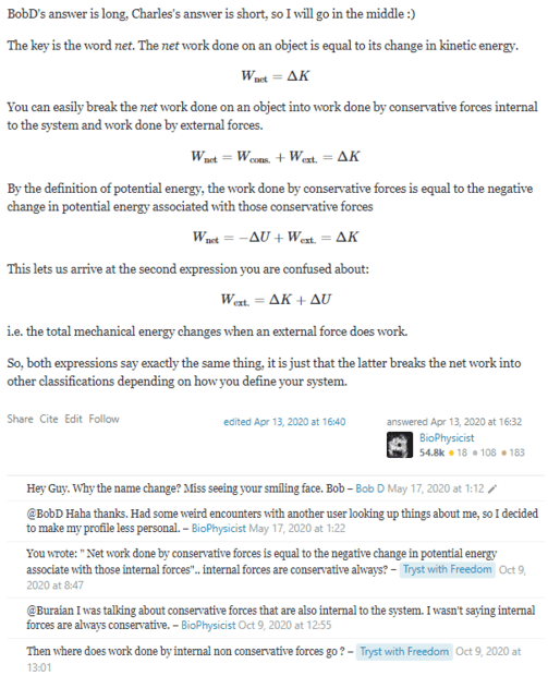

As I understand it, the formulation of the work-energy theorem for mechanical systems is $$\Delta K=W_{net}$$ where ##W_{net}## is the sum of all the works done on the components of the system by external forces, i.e. the total work that crosses the system boundaries.
The point that the textbook example wants to make is that application of the work-energy theorem to the two-component Earth + book system doesn't work and here is why. The change in kinetic energy is zero while the only work that crosses the boundary is that done by the man on the book which means that ##W_{net}=W_{man}.## So according to the work-energy theorem as formulated $$0=\Delta K=W_{man} \implies W_{man}=0.$$ which is certainly an absurd result.
The work-energy theorem works fine for single-component systems but fails with multi-component systems in which there are internal forces between pairs of components, i.e. deformable systems, an example of which is the Earth + book system1. That's what I think is "krooked" and can be set straight by invoking the higher authority of total energy conservation of which the first law of thermodynamics is an example.

Thank you @haruspex, @nasu, @malawi_glenn , @kuruman, and @gmax137 for your replies!
So it turns out work energy theorem is actually valid in this case! However, we just have to remember that
##W_{net} = W_{applied} + W_{conservative}## as found on Physics SE.

I also do not understand why non-conservative internal forces are being ignored.
If I strike a cold squash ball with a racket, a lot of the work goes into warming the ball.
