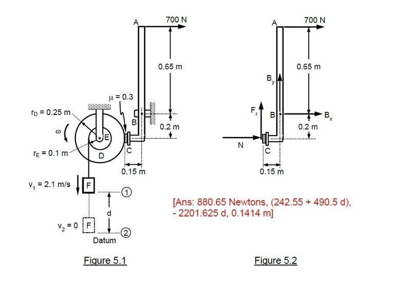

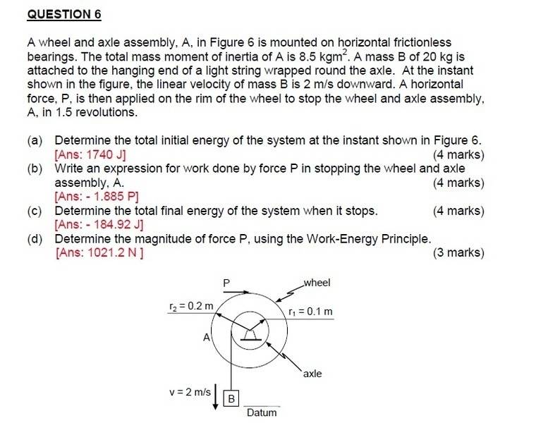

I don't how how to work out for the Gravitational Energy "H".
Info given is 1.5rev converting to 9.42rad/s
S=rδ
S=0.2x9.42
=1.884
*Should i multiply the axle radius or wheel?
E1=K1+G1+S1
=1/2(8.5)202+(20)(9.81)(H)+0Thanks

Your expression for the kinetic energy is not correct. How do you calculate the kinetic energy of a rotating object? The hanging mass also has kinetic energy at the initial time.
Since the mass is located at the "datum" at the initial time, you can consider the potential energy to be zero at that time.

The equation should be:
1/2(8.5)(20)2+1/2(20)(2)2+G1+0
Rotational as "1/2(8.5)(20)2"
Linear as "1/2(20)(2)2"
G1-don't know how to form
S1 as 0 because there is no spring

All right. I didn't know what the symbols S and G were standing for. As you say, there's definitely no spring potential energy. For the gravitational potential energy, note that the hanging mass is located initially at the "DATUM". That's the point where the gravitational potential energy is taken to be zero. So, G1 = 0.
Did the box go down eventually? To my understanding yes because that question says in 1.5 rev" So that means the box travel 1.5 rev downwards.
So i set my datum point at the 1.5 rev point, hence there is gravitational potential energy at the initial position which i am trying to calculate but i don't know whether to use the axle or the wheel radius.

Yes. So, when you go to part (b) the box will be below the datum.
[EDIT: Did you use the correct radius for finding this distance?]

You don't want to change the datum point. The answers you gave are for the datum shown in the picture. So, if you want to get the same answers, you need to keep the datum as shown.
The string tied to the box is wrapped around the pulley of radius 0.10 m. So, that's the radius you want to use to convert angle of rotation to linear distance traveled by the box.

For part (b) you just need to calculate the total energy at the final location. What is the kinetic energy there? What is the potential energy there?
[Sorry, that's for part (c)]

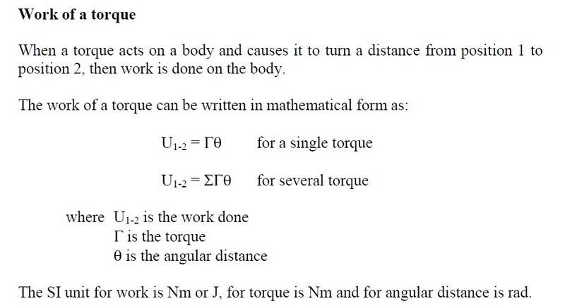

Confusion is normal. We'll get it. The questions in the problem are sort of guiding you through step by step. So, in part (a) you find the initial energy. In part (c) you will find the final energy. For part (b), you just need to find an expression for the work done by the force P.
You have posted a couple of pages. One expresses the work in terms of force and distance, the other in terms of torque and angle. You can use either one of these expressions. They will yield the same answer.

The force P acts over a distance equal to the arc length, s, that a point of the rim travels as the wheel rotates through an angle δ. The relation between s and δ is s = r.δ
The work done by P is just the force times the distance s: work = -P.s
But note that we could express this as work = -P.(r.δ) = -(P.r).δ = -T.δ = -torque.angle.
The force P does not do both "linear work" and "rotational work". The definition of work is just force times distance (when the force is parallel to the distance, as here). So, work = -P.s and that's it. It's just that sometimes you will see this work expressed as -T.δ. It represents the same work.

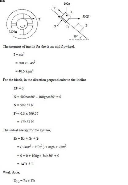

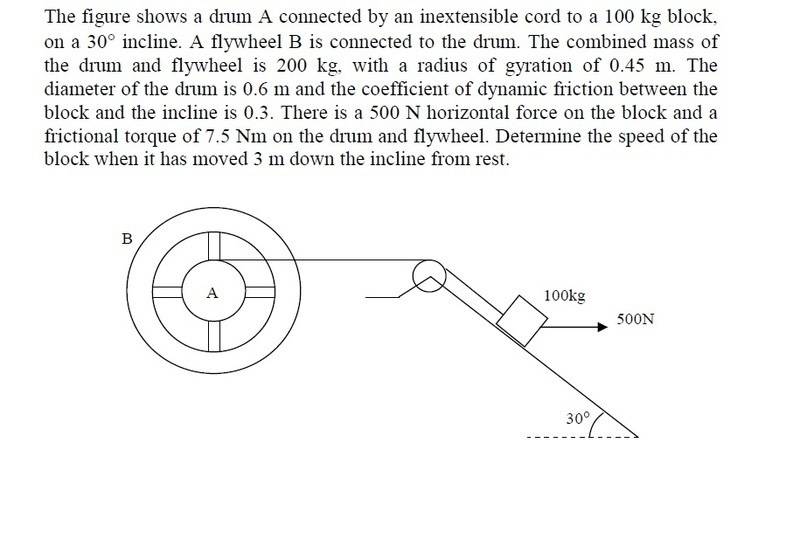

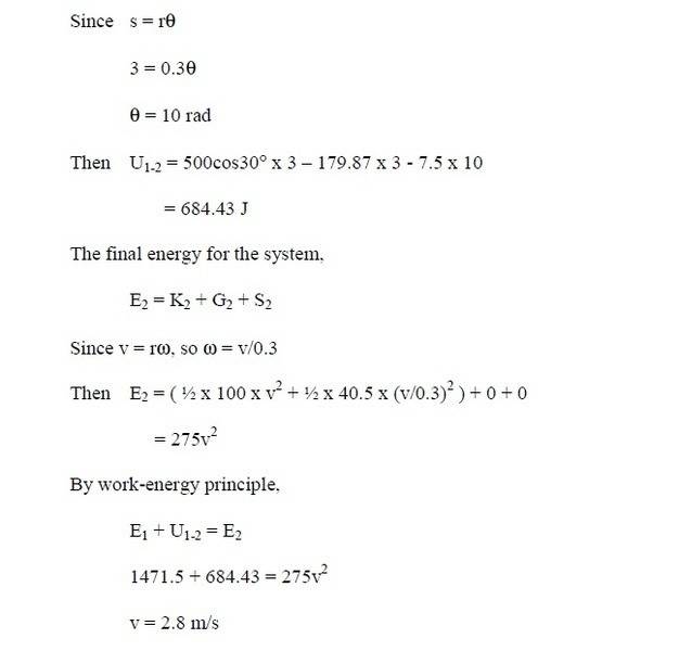

Then how do you explain this?
2nd diagram "Work done = Fs+Tδ"
I know there is rotational and linear motion.

They are calculating the work done by three different sources here. For the work done by the frictional torque of the flywheel, they use T.δ. For the work done by the force of friction on the slope they use F.s and for the work done by the 500 N force they use F.s.cosθ
They never use F.s + T.δ for the same force. It's either one or the other: F.s or T.δ
