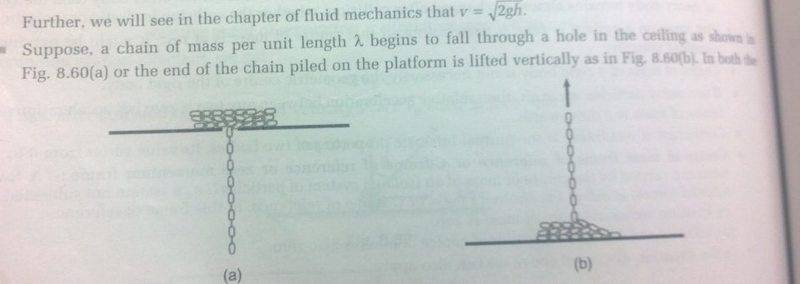

(here is another pic:

Why can't i use work energy theorem for a chain sliding down a smooth hole? Also, why can't i apply thrust force in the case of a chain sliding of a table? When the chain falls through a smooth hole, its vertical velocity increase. So why can't the change in kinetic energy be equal to change in potential energy? For a chain falling through a smooth hole, the mass of the chain that hasn't piled up decreases. The change in momentum due to change in mass is taken as thrust. (?)
I need your help in deriving the expression for thrust in case of a chain sliding through a smooth hole assuming that it does not pile up as it hits the floor.

This hole problem fools some of the experts, so don't be surprised you are struggling with it.
It is discussed in section 1 of https://www.physicsforums.com/insights/frequently-made-errors-mechanics-momentum-impacts/.
You should doubt conservation of work when there is an apparently infinite acceleration. The portion of chain on the table is considered to be at rest, but as the next bit heads into the hole it somehow gets up to the speed of the falling portion instantly.
The clincher is that when you apply conservation of momentum (or, equivalently, the analysis you quoted in the OP) you get a different answer.

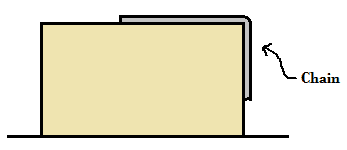

This is the given situation:
Correct me if I am wrong.
As the chain begins to slide, "The portion of chain on the table is considered to be at rest". It is pulled by the vertical part and begins motion instantaneously. So I can't use work-energy theorem?
I am not able to understand why "The mistake is the assumption that work is conserved even though, as each element of string is picked up in the departing thread, it apparently accelerates instantaneously from rest to speed v."
In the above case, the gain in kinetic energy=loss in potential energy. I can find the potential energy of the chain by using integration. (taking the top of the table as zero potential energy level).
So whatever answer I get is wrong?

No, you're mixing up the two cases. The comments of mine that you quote above were for the chain falling through a hole (or being pulled straight up) from a loose pile.
Your diagram in post #7 is the other case, the chain falling off the side of a table. Also, it shows the chain as laid out straight on the table. In this case, the whole chain accelerates together and is taut at all times. In consequence, there are no seemingly infinite accelerations and work is conserved. The difficulty now is that the diagram shows the hanging part only as it would be right at the start. Once the system is moving, it will not hang straight but arc away from the table. This makes it hard to know how high the mass centre is at any given time, so hard to figure out how much PE has been lost.

Same problem can also be found in the book by I.E.Irodov. Both have assumed that table has a height greater than length of chain. Hence the center of mass is at a distance y/2 from top where y is the length of the overhanging part of chain. Also, they might have assumed that the chain sticks to the table and does not arc from the table.

In order to get y/2, you will neeed to make such an assumption. But it should not be an assumption. The question statement should give you some reason to take it as the case. Moreover, the sticking to the side of the table needs to be achieved in such a way that work is conserved. That is, the lost horizontal KE has to be converted into vertical KE. That is why some formulations mention a smooth tube ducting the chain from horizontal to vertical.

Edit: to clarify, the rest of this post is in relation to the case where the chain falls through a hole in the table.
It's not that the acceleration can really be infinite. It's just that in problems where there are very sudden acelerations, impacts, it is often the case that work will not be conserved. In general, it is safer to assume that it is not. If there is enough information to solve the problem without assuming it is conserved then that is the right way to go.
In this specific case, there is enough information, the answer shows that work is not conserved, and the reasons why it will not be conserved are discussed at the page I linked to ("where did the work go?").
