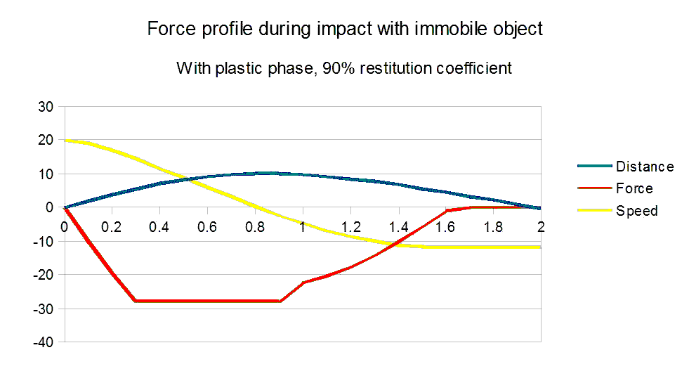

4. Non-conservation of work
In general, an impact has three phases:
  • an elastic compression phase, where the force grows roughly in proportion to the extent of deformation;
  • a plastic phase, where the force may remain roughly constant for a while, or even reduce a little;
  • an elastic rebound, approximately reversing the elastic compression phase. The force/deformation slope in the rebound will typically be less than in the elastic compression phase.
These diagrams illustrate some possible force-time profiles.
force profile
impulse profile
Thus, work energy is lost in two ways: the deformation in the plastic phase is not recovered, and the force at a stage in the rebound may be less than in the corresponding stage of the elastic compression phase.
  • An elastic collision is a collision in which no work is lost.
  • An inelastic collision is a collision in which some work is lost.
  • X A completely inelastic collision is a collision in which all work is lost.
  • ✓ A completely inelastic collision is a collision in which the maximum possible work is lost.
