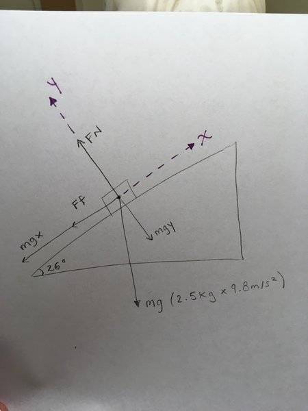

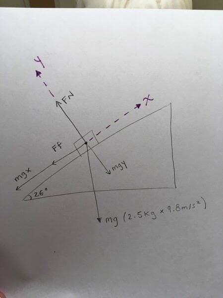

Hi! I'm having issues with this practice problem. Any advice on what I'm doing wrong would help!
A 2.5 kg particle is projected with an initial speed of 3.3m/s along a surface for which the coefficient of friction is 0.7. Find the distance it travels given that the particle moves up a 26 degree incline.
W=ΔKE
W=F*d
Ff=μFn
W=ΔKE+ΔPE
KE=1/2mv2
PE=mgh
mg=2.5kg*-9.8m/s2=-24.5N
-24.5Nsin26=-10.74 N = mgx
-24.5Ncos26=-22.02N = mgy
ΣFy=0=Fn-mgy
Fn= 22.02 N
Ff = Fnμ
Ff = 22.02N*0.7
Ff=15.14 N
W= KEf-KEf+PEf-PEi
W=.5mv2-.5mv2+mgh-mgi
W=0.5*0.3kg*(3.3m/s)2-0+2.5kg*9.8*h-0
W=F*d
Here I assumed KEf was 0 because the final velocity is 0, and I assumed PEi was 0 because the inital height is 0.
The forces applied that aren't in equilibrium are mgx, and Ff.
W= (-15.14N-10.74N)*d
-26.15N*d=0.5*0.3kg*(3.3m/s)2-0+2.5kg*9.8*h
So instead of having 2 unknown variables, I made h equal to...
h= d*sin26
So.. I inserted that in the previous equation:
-26.15N*d=0.5*0.3kg*(3.3m/s)2-0+2.5kg*9.8*d*sin26
Factored out d...
d(-26.15+24.5sin26)=-13.6125
d=-13.6125/(-26.15+24.5sin16)
d=0.88m
And this answer is incorrect. I am unsure where I went wrong... Any thoughts? Thank you!
For an image of what my free body diagram looks like, I posted it below!

Please explain how you have defined your coordinate system.
Using a free-body-diagram would be helpful.
You are using two different expressions for work.
The net work is given by Wnet = Fnet⋅d ,
and is related to the change in kinetic energy by: Wnet = ΔKE .
The work done by non-conservative forces is related to the change in PE and KE by: Wnon-con = ΔKE+ΔPE .
You were using these interchangeably, and therefore accounted gravity's effect twice.

Ohhh! So.. Work will be
Wnet=Fnet*d
and Fnet will only be equal to that of the frictional force?
No, the gravitational force is still there.
Both friction and gravity do work here. You know both of these forces and the initial kinetic energy. So how much work is required by these forces to bring the kinetic energy to zero?
The net Force: That's the sum of all the forces not in equilibrium. You previously had that correct. Use this for net Work, Wnet.
Work - Energy Theorem: Wnet = ΔKE.​
Otherwise, use the WN.C. work done only by non-conservative forces.
The only non-conservative force here is friction.
WN.C. = ΔKE+ΔPE​
It appears that you keep mixing these two this together ..

Other than mislabeling and some sign errors this should work.
What you call Fnet here is just the friction force: That's the Non-Conservative force, not the net force. The work done by this force is equal to the change in KE+PE .
You messed up the change in KE. Final minus Initial is negative, Right?
Finally, you have an Algebra error: added PE rather than subtracting .

This is what I did, based on my conversation with Nfuller
Wnet=f*d
f=Ff+mgx
Ff+mgx=-1/2mvi^2
(-15.14N-10.74N)*d=-(1/2)(2.5kg)(3.3m/s)^2
-25.88N*d=-13.61
d=0.52m
