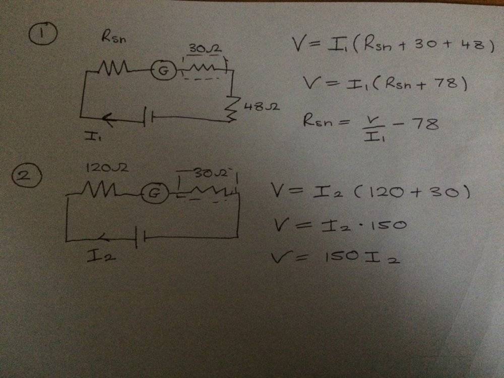

I have tried to draw the set up for both cases which the question had described above, and came to these 2 equations. But I can't see how it would help me to work out the resistance of the shunt?
Handwritten circuit diagrams with derivations: circuit 1 has shunt resistance Rsn, a galvanometer G, a 30 ohm resistor and a 48 ohm resistor with current I1; circuit 2 has a 120 ohm resistor, galvanometer G, a 30 ohm resistor and current I2.
Any help would be really great! Thanks
The shunt should be in parallel with the galvanometer, not in series. See here.

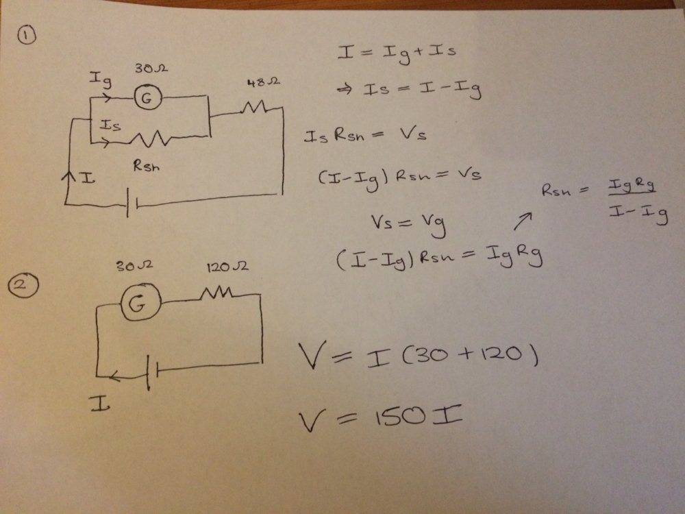

Ok I have made the changes to set up 1 and get these equations now
Handwritten working on paper: circuit 1 shows galvanometer G with 30 ohm coil in parallel with shunt Rsh, in series with 48 ohm resistor and battery; equations I = Ig + Is, Is Rsh = Vs, Vs = Vg, Rsh = IgRg/(I - Ig). Circuit 2 shows G (30 ohm) in series with 120 ohm resistor; V = I(30 + 120), V = 150I.
How are ##I## and/or ##I_g## in part 1 related to ##I## in part 2?

Sorry I believe the I value in part 1 to be different to the I value in part 2?
To go about this question, I know that the voltage of the cell stays fixed in both cases. So could I find an expression for V in both part 1 and 2. Then equate them and solve for R_sh (the shunt resistance). I don't think this would be right as I would have more than 1 unknown there

It's not the voltages that you should set equal. Reread the sentence that starts with "When the shunt is removed ..."

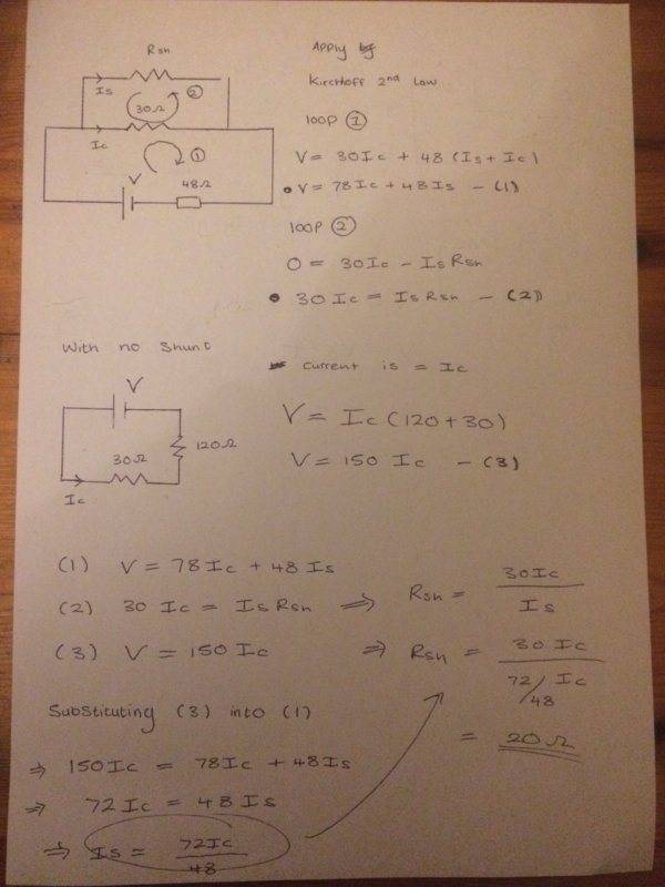

OK I have had the time to rethink about this problem again. And I have redrawn the circuits again. This time I made use of Kirchhoff's 2nd law to help me
Handwritten working on paper: a shunt circuit with resistor Rsh, 30 ohm and 48 ohm resistors, Kirchhoff's 2nd law loop equations V = 78Ic + 48Is and 30Ic = IsRsh, a no-shunt circuit giving V = 150Ic, and final substitution yielding Rsh = 20 ohms.
I got a shunt resistance of 20 ohms here?
