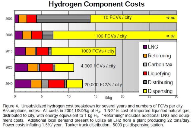

Right now? Odd, I thought we'd been through this before. I forget what supplier our chem/bio lab uses now, but my retail price exceeds $100 / kg DELIVERED.
http://www.airgas.com/browse/product_list.aspx?catID=195&WT.svl=195" List Price Quote this month ($5B industrial supplier):
Cylinder fill/swap (300 cu ft cylinder, actual 261 cu ft = 0.62kg H2) at 2200 PSI on site:$62
Delivery + hazmat fee: $39
Delivery Fuel surcharge: $11
Total: $118/kg plus $78 cylinder lease.Break out of total costs from a study:
http://198.173.87.9/PDF/Doty_H2Price.pdf
But mheslep, you're quoting prices on cylinders... You can purchase it that way, but I can assure you, the price you're paying is all labor and various overhead costs. It has nothing to do with the value of the hydrogen. Customers that buy in bulk, such as 13,000 gallons of liquid hydrogen at a shot don't pay anything like that. It's on the order of $4/kg when purchased in quantity. So for a typical customer that has a liquid hydrogen tank, even with the cost of leasing the tank, dispencers, and compression equipment, the cost only goes up an additional few dollars per kg. These are not unusual customers either, they may have 50 or more forklifts at a warehouse. You could similarly imagine a hydrogen refueling station on your street corner that could refill one car every 5 minutes (288 fills/day) located near a hydrogen plant. Such a refueling station could sell hydrogen to a typical drive up customer at $4 to $5 /kg and still make a substantial profit.
I know, I labelled the information as a retail list price for cylinders.
That's part of the nature of distributing H2. It's 99.9% truck and driver.
Total cost, as it goes into the tank in the fork lift, or other vehicle? I think you are mistaken. Certainly the price comes down, but not that low, delivered, and including storage. As shown in my previous post the cost of LNG and reforming to H2 is ~3-4/kg, but the distribution and storage H2 is expensive compared to gasoline. I see http://www1.eere.energy.gov/hydrogenandfuelcells/pdfs/liquefaction_comp_pres_praxair.pdf" (pg 8) the cost of electric energy alone for liquification, no capital costs or anything else, is $1.2 to $1.50 /kg of H2.
In the future that price may come down, but I was challenging the assertion of a given price "right now".
Q_Goest said:
So for a typical customer that has a liquid hydrogen tank, even with the cost of leasing the tank, dispencers, and compression equipment, the cost only goes up an additional few dollars per kg. [...]
Source for any of this?
If you want an H2 plant close by, then to be fair in comparison to gasoline you need include a prorate of the H2 plant in the refueling station cost. My current gallon of gasoline was probably refined a 1000 miles away in Louisiana, and I still pay $2.80 for it.
__________________
Hi mheslep,
Regarding costs I've quoted, I work as an engineer developing compression equipment for the hydrogen energy market. The costs I've quoted are what I've seen as being 'in the ballpark' of what is typically paid for hydrogen in bulk and for the ancillary equipment. I've tried to be as accurate as possible and I've checked the costs I'm posting.
Yes, good point. But there are pipelines for petroleum products all over the US (unlike hydrogen). The cost of transportation for these products is minimal. In essence, you ARE very close to a source of petroleum. I live in PA and there's a pipeline from the gulf coast that extends up to where I'm at. Hurricane Katrina for example, knocked out pipelines up the east coast that caused a dramatic increase in the cost of gas before those pipelines could be repaired. Here are some maps of various petroleum pipelines in the US:
http://www.rextagstrategies.com/downloads
Q_Goest said:
Hi mheslep,
Yes I recall you mentioning background, that's why I'm particularly interested what detailed information you might provide, e.g. 300 kg H2 tube trailer cost, hazmat delivery costs, onsite storage costs, onsite energy costs for liquification or compression, etc.
Exactly so. No doubt you are familiar with the economic difficulties of attempting the same with an H2 pipeline - expensive to maintain, more pipe section to push the same number of joules as CNG, etc. The US has some one million miles of hydrocarbon pipeline, only ~300 some miles of H2 pipe, and most of that is in that http://www1.eere.energy.gov/hydrogenandfuelcells/pdfs/liquefaction_comp_pres_praxair.pdf
Cost depends on a number of factors including shipping charges and whether or not the customer is looking for just a single delivery or has a long term contract. For what it's worth, hydrogen gas in tube trailer form is much more expensive than liquid. Costs for tube trailer hydrogen are in the ball park of $14/kg with significant adders for trucking and single deliveries.
Exactly so. No doubt you are familiar with the economic difficulties of attempting the same with an H2 pipeline - expensive to maintain, more pipe section to push the same number of joules as CNG, etc. The US has some one million miles of hydrocarbon pipeline, only ~300 some miles of H2 pipe, and most of that is in that http://www1.eere.energy.gov/hydrogenandfuelcells/pdfs/liquefaction_comp_pres_praxair.pdf"
I'm reasonably familiar with the pipeline but I guess the point I'd like to make is that the costs for hydrogen right now are not what they could be if various other sources were to be developed. There are ways of producing hydrogen from water or bio sources for example, that might not be cost effective today because they're still in the research phase. In the future, the hope is that these technologies will be able to produce "green" hydrogen at a cost equal to or less than the cost of hydrogen today.
Q_Goest said:
... such as 13,000 gallons of liquid hydrogen at a shot don't pay anything like that. It's on the order of $4/kg when purchased in quantity. ...
Backing up here. So the common US 18-wheel gasoline tanker truck carries 9000 gallons. I'm curious as to how the 13,000 gallons of liquid H2 you referenced is delivered? Multiple tankers of what capacity? The end user, the large warehouse in our example case, must have a similarly sized storage facility.
13,000 gallons is a typical LH2 trailer load. That's 1 trailer. Gasoline tankers are smaller no doubt because gas is much heavier per gallon than LH2.
I'm sorry to hear that mheslep. But the fact is, most people that drive FCVs pay only about $3.50 a kg for their H2 when bought at a fueling station.
http://www.fuelcells.org/info/library/QuestionsandAnswers062404.pdf
