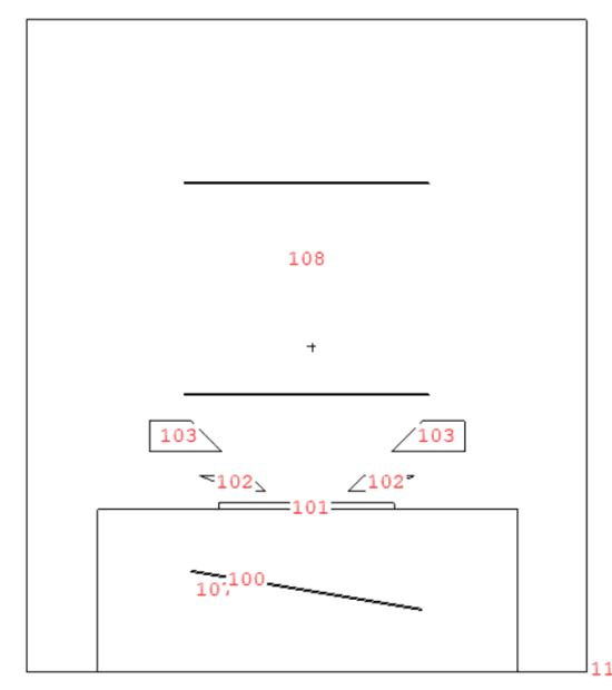

I don't know where is the problem. My supervisor couldn't provide me the actual specification of my X-ray tube. I was asked to simulate the X-ray narrow spectrum beam. I run that code, but it produces nothing. Can anyone help me?
I ran that at 1/100th the nps in MCNP5 and it produces a spectrum for me. The electron voltage might be set at the RMS of the supply voltage of the tube. That would limit the spectrum a bit, it's not fully correct.
Also of note "e0 0.001 100i 0.328" is a linear interpolation and an electron at 47.9keV can't produce an X ray photon above 47.9keV so most of the spectrum must be blank under these conditions.
If you still think you are getting nothing add your output file to a post.
Here is my output.
in your file "sdef par=2" emits photons not electrons. You must write par=3

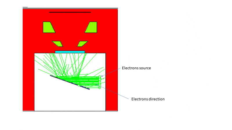

I make some modifications (see my input and output).
first I modified sdef :
"sdef POS= 5 0 0 PAR=3 ext=0 ERG= 0.06 AXS= -1 0 0 vec -1 0 0 DIR= 1 RAD=d1"
I put "par=3" to emit electrons and not photons
I create an electrons beam on the W target (POS= 5 0 0 ext=0 AXS= -1 0 0 vec -1 0 0 DIR= 1 RAD=d1)
It gives :
I transport electrons only in cell 100 and 107 (imp:e 1 0 0 0 0 0 1 0 0), because there is no point in transporting electrons outside of these areas except to increase the calculation time!
I put a F5 tally at 3 cm (in front of the aluminum filter) and F15 at 10 cm (behind the aluminum filter) note that F4 and F1 did not converge with few particles
it gives this results :
hope it's help

Hi @Alex A and @PSRB191921. I am sorry, i uploaded the incomplete output file. In the mean time, i have changed the geometry. I have changed the par and tally too. But when the electron is emitted, it doesn't collide with the tungsten target. I am not sure why this is happening. Can you help me please? I am uploading the input and the output file here.
You have a fatal error,
" fatal error. 9 entries not equal to number of cells = 10."
This seems to apply to,
Code:
imp:e   1 0 1r 1 0 4r          $ 100, 109
This is the same as,
Code:
imp:e   1 0 0 1 0 0 0 0 0          $ 100, 109
So you've assigned 9 importances when you need 10.
I have corrected this fatal error, but still no photon is being recorded. i am attaching the input and output file.
Your void cell is 107, this cell needs to have 0 importance for all (both in this case) particles.
