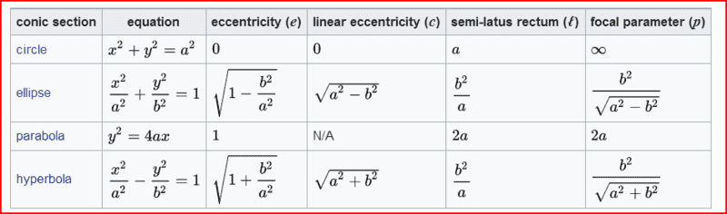

berkeman said:
Do you see how the powers of the variables are different for the different conic sections?
From the Wikipedia article on conic sections:
https://en.wikipedia.org/wiki/Conic_section
I apologize but that doesn't answer my question as well I was insulted first and your the insults I'm afraid. I wish to dissolve my account at this point. The services of your members are no longer required by me.
Thread is closed for a bit...
Eric Sepich said:
A circle is simply a form then of conic and so is a parabola. They should overlap at some point. ?
As already mentioned, the equations are different. The equation for a parabola is first degree in one variable and second degree in the other variable. For a circle, both variable occur to the second power. I don't know what you mean by "they should overlap at some point."
The equation that @berkeman shows in the table, ##y^2 = 4ax## is of a parabola that opens to the right (if a > 0). The equation ##x^2 = 4ay## is that of a parabola that opens upward.
Your equation, ##y = cx(L - x)## is a parabola that opens downward, assuming that both c and L are positive constants. There is no value of c that makes this the equation of a circle.
