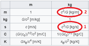

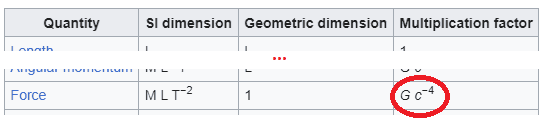

Did you look at the wikipedia link? Your first two values come right off the table there:
And the second two can be obtained from the first two with the additional conversion factor
