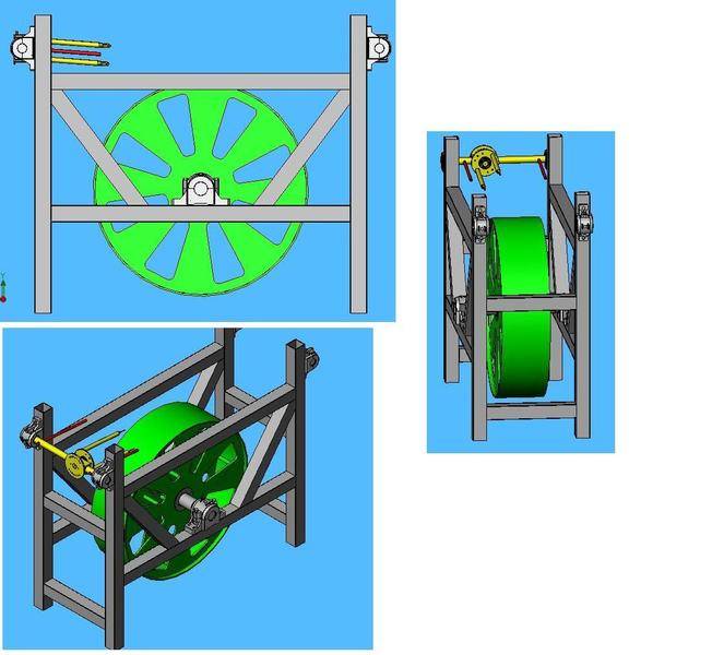

how to choose appropriate shaft
Hi,
I need to build a kind of a test device for bicycle rims. Already attached some pictures of the design. The problem is I'm not a mechanical engineer and don't know what the principles for choosing the right shaft.
There is a big metal drum placed in a frame and it is going to be 130cm diameter nearly 320kg. The rims going to be placed on the yellow tilting mechanism. By applying load ( 50-100 kg on each arm)to red arms and turning the drum, rims will be tested. I will use an electrical motor which is placed outside of the frame and the transmission is going to be with a belt. This is the basic idea. However I don't know how to calculate the diameter of the drum shaft that I need.
I already checked the google and try to find out something similar to that "device" but couldn’t find it. There are lots of information like bending moment and torque but they are not that much easy for me to understand. I hope u guys help me.
