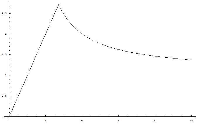

Hello guys. I don't think it's just y=x. I've attached a rough plot of a curve I think all real solutions (in first quadrant) are on but can't prove it.
I think there should be a straightforward proof that there are exactly two (real) solutions for y, for each x, except for when x is... (reaches into my magic hat)... e. I just can't remember what the proof is. :biggrin:
If you happen to recall the proof that 2^y = y^2 has exactly two solutions, that should generalize to this problem.
BicycleTree said:
Hello Bicycle. I checked out your reference. Thanks. I found it an interesting exercise to convert:
x^y=y^x
using the substitution y=kx yielding the parametric equations:
x=k^{\frac{1}{k-1}}
y=k^{\frac{k}{k-1}}
However, when I plotted this, I did not obtain the line y=x. Attached is the parametric plot.
The reason you don't get the y=x solution is that you assumed k was not 1 when you took the (k-1)-th root of the equation.

Oh man this is exciting. Check out this plot!
Given some value fixed value of x then a solution of y will be:
y = - \frac{x \text{ProductLog} \left( -\frac{\log x}{x} \right)}{\log x}
According to mathematica. This gives you a graph like so:
