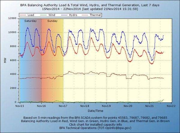

GRID & WIND:
First I'd like to address the MYTH that the electrical grid is old and aging.
Power delivery companies spend fortunes improving the grid to insure that when you flick a switch the power is there. It's in their propaganda that they send with each bill ;)
The real issue is the wind turbines etc throw great spikes onto the grid and require capacitors to smooth the power out, otherwise it's a nightmare for the grid manager, they need smooth power and only smooth. Otherwise grid Equipment and end user electronics would fry.
That Said, this is spun this way to get the ratepayer to pay for the experiments in wind power.
IF the states were to require that the wind power investors pay for the improvements required to connect, we would instantly see that wind is not cost effective and not a viable alternative. it is barely cost effective WITH this large piece of the cost moved to the other side of the balance sheet.
On an individual scale, it works for homeowners somewhat, but as a grid source not so much.
I can guarantee that in 20 years the next hit on ratepayers will either be expensive repairs
on great fields of these turbines or expensive demolition.
it's a noble idea, but it is NOT working the way the current business and subsidy's for it are set up, it is only serving the shareholders and not the ratepayers. ANY way you look at it.
in a word a boondoggle.

  • #837
Watchman2012 said:
GRID & WIND:
First I'd like to address...
There's a lot of misinformation and misunderstanding here. Where to start...
Wind: The problem with wind isn't the economics, not even 20 years from now. As far as alternative energy goes wind is actually rather cheap when done correctly. The problem with wind power is that it isn't energy producing, its energy farming. Power is only provided when nature says so, not when the grid demands it.
Oil: "Drill baby drill" is one of the most imprudent catch phrases that I think has ever existed. Why does society think the solution to a problem is the same actions that caused it? The bottom line with oil, its a very very expensive energy source. The problem is that the true cost of oil isn't seen until long after its been purchased and burned. Pollution, oil spills, green house gas production, its all going to cost a lot of money in the end with regards to dealing with the aftermath of burning it. We just haven't been faced with those costs yet (not economically anyway).
Electric Transport: Granted, we will never have affordable electric cars that can go 300 miles while carrying 4 passengers. However, that doesn't mean that battery powered vehicles don't have their place in this world. A good fraction of the world lives in cities and high population density areas where electric cars make a lot of sense. Will they work for everyone, no of course not. Do they have the possibility of making up a large portion of the cars that will be on the road, absolutely.
I hate to burst your bubble about hydrogen buts its happening. All major auto manufacturers are planning on selling hydrogen fueled vehicles by the end of 2015. Several are already in the first phases of production. I actually had the pleasure of driving the fuel cell powered Toyota Hylander, Kia Tuscan, Honda Clarity, and GM Equinox earlier this summer. And another thing, hydrogen is not cheap and abundant. It doesn't exist anywhere on Earth naturally, it must be produced from an energy source. Also, you do know gasoline is flammable right? Worse than that, it exists in liquid form at typical pressures and temperatures. And the Hindenburg didn't just burn because it was full of hydrogen, its skin had a chemical make-up similar to thermite. What do you think would have happened if it was filled with gasoline?
Regardless of your politics, there is no other available fuel that pound for pound compacts the huge amount of energy that is in petroleum oil.
Incorrect. Hydrogen has 2.7 times the specific energy of gasoline. H2 actually has the highest energy density than any other chemical fuel. You just can't beat protons for energy density.
Nuclear: You need to understand the circumstanced of the Fukishima disaster. This was a power plant that was designed in the 50's, built in the 60's, survived a very powerful earthquake, and was then hit by a tidal wave. The plant was placed in a terrible location and didn't have adequate protection from tsunami's (obviously) like it should have. I'm not an advocate of nuclear power, but it can be a very safe and practical form of power production when done correctly. With the advent of the computer and other technologies, much safer and more efficient nuclear power plants can be built. It justs costs an enormous amount of capital to build one. Germany and Japan's decision to nix all of their nuclear power and replace it with coal was just plain idiotic IMO. I'm not a big fan of nuclear but I think its the best practical option we have for "clean" power in the near future.
Summary:
Let the free market dictate those, leave it alone, focus on solving FUSION.
Fusion is very very very very very hard. It is an immense engineering and scientific challenge to create a reactor that is just only self sustaining. I doubt I'll ever see it in my lifetime and I'm in my mid 20's.
As for politics, don't count on anyone is washington to make the effort. I don't care if its democrats, republicans, or the wizard of Oz in office the only thing politicians care about is getting re-elected. The American people just don't really care about the environment or sustainability when compared to other issues like the economy and gay marriage so politicians aren't going to focus on it until it becomes a major issue. Besides, new technology costs money which no one wants to spend with the huge deficit and wars. When the droughts continue on through this year and the next, food prices increase, and potable water becomes scarce, then people will start to care. Of course by then we will already be up the creek.
Now the rest of the world on the other hand is a different story. I had hopes that Europe would be the pioneers of clean energy until their economy began to collapse. Guess its up to Japan and Iceland now.
